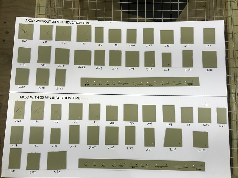

I did an experiment to answer these questions. I set up two groups of aluminum coupons, which were all treated alumiprep dip/rinse then alodine dip/rinse and air dry. Once dry each coupon was marked with an "x" in sharpie. I set out each group of coupons in a line and sprayed a very light (airbrush) coat along the entire line. Then repeated the light coat along the entire line, excluding the first coupon. Then the second, third, etc..... So that the first coupon had a single light coat, and the second had two, the third had three, etc..... I did this with the first group of coupons without the 30 min induction period, and the second group with paint that had undergone the 30 min induction time.
I measured the mil thickness of each coupon (using Carsys meter), in order to establish a visual reference for myself while spraying to achieve the proper thickness.
I also sprayed a strip of aluminum (same prep steps) with each group, and dimpled it at intervals after spraying to see at what point dimpling could be done, and if the 30 min induction changed the interval necessary.
Here are the results:
2hqJbaF
I think my experiment answered my questions as follows:
#1 - Thickness visual measure achieved. Hopefully, the pic can help someone else with this and save them repeating the experiment.
#2 - It does look like the induction time lead a more consistent spray thickness over the spread of the coupon group (although It could also have been my technique). It also looked like the final dimple kept better coverage in the induction group. I scratch tested the coupons that fell in the proper thickness range for the induction and non-induction group and could not tell any difference. So it looks like 'recommended' improves some things in the final dimple. And I would use it if I were planning to dimple after priming, however.....

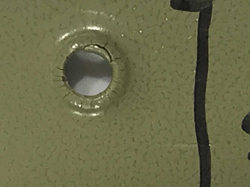

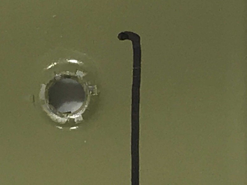

#3 - I found that dimpling after priming will lead to splitting of the primer even after the full cure time. It decreases over time. Here it is early after priming...
2hqGmu9
And then after 24 hours of cure......
2hqGmt2
So from this, I conclude that if dimpling after priming it would be wise to use the 30 min induction, and wait at least 24 hours (or more) prior to dimpling if the akzo will be the only protection. However I'm considering using an Alodine 871 Touch-Prep treatment to the hole after dimpling to ensure that areas of primer distortion are protected from corrosion. I imagine this is not a surprise to anyone with experience in this. But I thought posting my data points might help someone without the experience, such as myself.

The dimple tests look to be too thick. What is the mil thickness on those? Especially the second one. It looks like you have solvent pop/crazing.
Your color swatches match what my experience has been. It should go to just opaque and smooth. If it goes glossy or wet it?s too thick. I get right at 1 mil dry thickness when I measure with mics.

I measured the mils on the dimple coupons, and the last one was indeed very thick. Nearly 3 mils - so that explains the appearance. The first one was not overly thick, but was dimpled early after priming, which explains it appearance I believe.
I should note that none of the akzo splitting was visible to the naked eye. I could only see it when magnified. So I will continue to watch for that in my QC.
I dimpled the 1 mil coupon tody, which is now >48 hrs after priming. It looks good to me.....
For me the lesson is to do the 30 min induction and wait for a full cure prior to dimpling. Or if the timing works better, dimple prior to priming. All of the male die side of the dimples looked fine after just a short time, it was only the female die side that had issues, so I do think setting a rivet could occur fairly shortly after priming a pre-dimpled part. Compression does not seem to be so much an issue as expansion.

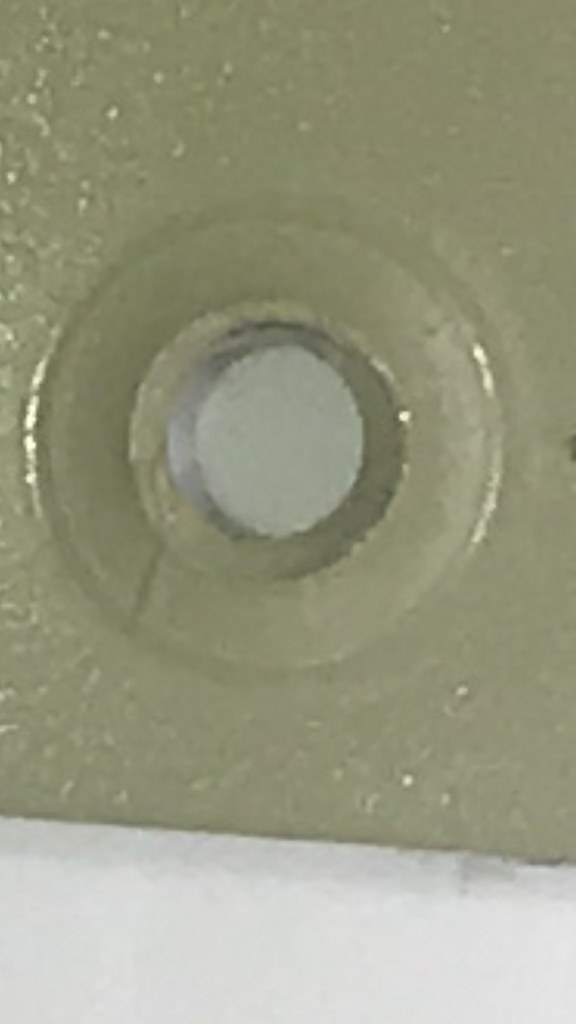

However, a week so after priming, I began to dimple the parts and noticed the primer was chipping and flaking around the dimpled areas. I had not experienced this issue in the past when using my previous prep method. As an additional note, there were a few longer parts that I was not able to fit in my alumiprep/alodine tubs. I prepped these parts using my old technique of scotchbrite and prekote scuff. These parts were primed the same day using the same batch of primer. These parts were later dimpled the same day as the alumiprep/alodined parts. However, there was absolutely no flaking or chipping of the primer on these parts.
My unsubstantiated thought is that the chemical etch does not provide the same amount of “tooth” for the primer to grab. Possibly adding a scotcbrite scuff to the alumiprep stage would correct that. However, the whole purpose for me to use the alumiprep was to skip the scuffing stage.
I would be interested to hear if others that use the alumiprep/alodine prep method , and dimple after priming, are getting the same results of chipping/flaking primer around the dimples. Unless, I can determine the cause of the primer flaking, I will return to my previous prep procedure using the prekote and scotchbrite scuff.

The pics above and below show the short piece that was prepped with alumiprep and alodine. The primer did not hold during dimpling.
[/url][/IMG]
[/url][/IMG]
The pics above and below show the longer part that was prepped with scotchbrite/prekote. Primer in perfect condition after dimpling.
