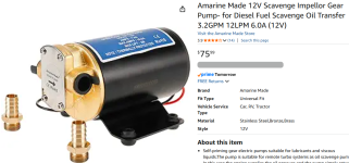

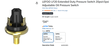

I have a pre-oiler on my IO-360. As mentioned above, I use a pickup on the sump and return at the top of the engine. I also use a pressure switch so it comes on in case of a low oil pressure situation (like before starting the engine) and set it to 25 PSI. Since most of the wear on our engines is on starting, I believe this may help. Also, while I doubt it will move enough oil to save my engine if the oil pump fails, it may give me a few more minutes (seconds?) of engine power. Because it is completely separate from the main oil system, I don't believe it will cause an oil pressure failure from the main oil system. A large leak might cause a problem, and any extra plumbing increases that risk, but I feel the benefits are worth the risk. There a cheaper switches but the pump will burn out pressure switches that can't handle at least 10 amps and most of those switches are 3 amp max (ask me how I know!).

See post #3. I just went with a pressure switch (no on or off switch) and a warning light comes on my EFIS.
