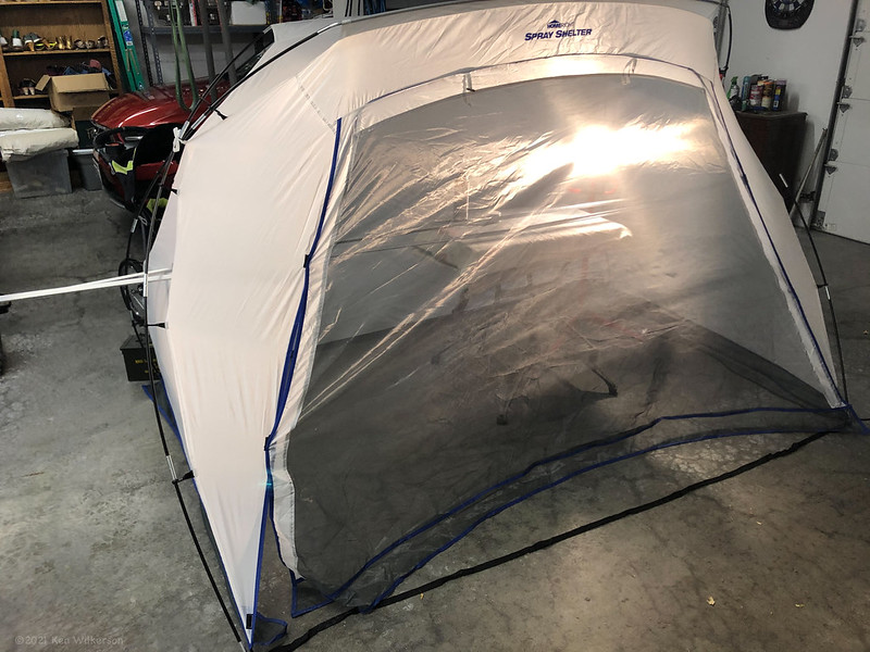

I built a downdraft paint booth using cheap bilge blower motors from Amazon. It worked well for all my priming.
Heres a short video of it.
90% of my priming was done on a drop cloth in my driveway.
The other 10% was done with an elcheapo pop-up spray booth I purchased on Amazon. This was in the dead of winter with 75% humidity and 52f in my garage at night with just a single quartz lamp to get the temp and humidity in the ball park inside the "spray booth".
