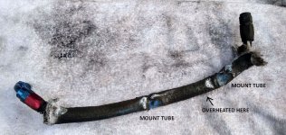

Also amazes me how many people don't read section 5 of the manual. I even tell people building other brands to read it...
and dispite opinions here, FIRESLEEVE the hose. Even if you do have a restricted fitting to lessen the volume of fuel, the firesleeve is there to protect not only hear but some abrasion as well. This was on a RV10 where the firesleeved fuel hose was rubbing on the exhaust for at least a year, by the log book. Had the braid been rubbing on the exhaust, it most probably would have created a hole. Check out the fuel pressure hose that was rubbing against something aluminum. Plated brass collar was no match. Any protection is a plus.
Who the *&^%$#@! is inspecting these airplanes?
Baffles the mind!
It amazes me how many people lack common sense! Gee: let's put this fuel line so it rubs against the exhaust. It has a fire sleeve so it should be OK, right? Ka f#%*&^# BOOM!! :oops::oops::oops:
Isn't reading a manual a direct violation of "The Guy Code"? ;)
Im NOT going to mention the Plane, the former owner, OR the A&P that installed the hose. This was found after the cowling was off for another issue. Had about 150 hours of installed flight time, as this RV10 was flying ALOT. After inspecting the section of the hose that was rubbing---you can see that the liner was not damaged. BUT--given more time, it could have been a bad situation. It even pressure tested prior to the autospy. A real eye opener for the attributes of teflon hose. But even a teflon assembly cant make up for improper installation. This was about 10 years ago, but even more critical now with more and more builders.
Tom
And this is what you get with a rubber liner, a "not quite rubbing the pipe, but close" installation error, again by an A&P. The rubber baked hard, cracked, and fed fuel into the firesleeve at ~25 psi. It caught fire at both ends and the airplane burned, on the runup pad.
Three A&P annuals, two owner/pilots, and nobody saw it.
Or they thought "The firesleeve will protect it". No, it won't. It's better than nothing, but fails address a fundamental physical property, the poor absorptivity and emissivity values for a rubber surface. Ballpark, you're looking at 0.9, vs 0.1 for a shiny aluminum foil surface. The silicone sheath provides fire protection and oil resistance, but it's a lousy reflector. Wrap it in shiny tape or buy a reflective sleeve.
Better yet, re-route the hose away from the hot pipe. A basic rule says the amount of energy received is inversely proportional to the square of the distance from the source. It means doubling the distance reduces heat transfer to 1/4, and doubling it again reduces it to 1/16. Think about that in terms of 1" separation, 2" separation, and 4" separation.
