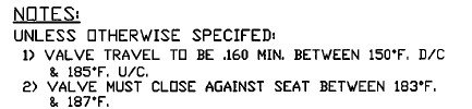

Follow-up to close this thread. My troubleshooting took me to the Vernatherm. I found it only expanding about half way meaning the oil was always bypassing the cooler. I replaced the vernatherm with a viscosity valve, aka oil bypass plunger. Flew it today (91 deg on takeoff) and found the oil temp was 15-20 degrees cooler. CHT's also came down almost the same amount. At cruise settings it stabilized about 190 OT and 385 CHT. This was the first flight I've been able to try WOT and the temps stayed below 200 OT and 400 CHT. The oil temp is a bit hotter than I'd like long term but I don't see the need to change the cooler right away.
For any future searches, here are some pics of the vernatherm and bypass valves. The vernatherm guts can be removed by pulling the wire clip and then the empty housing reinstalled to close the hole. For the bypass, you should not need the cap. That's what is closing the hole now. I didn't realize that so spent $30 more than I needed. I bought Superior parts which are WAY cheaper than the Lycoming, e.g. $20 for the spring vs $220. Just use an "SL" prefix for the Lyc part number.

Yes. It wasn't clear in my searches that they are 2 different locations. There is a Lyc SL that calls for removing the bypass plunger when a vernatherm is installed so this is a reversal of that. As Walt mentioned, the downside is no thermostat for the oil. Some folks have installed a shutoff ball valve in the oil cooler line to allow manual control. I'm in Houston so not worried about too cold oil and I'm troubleshooting. This buys me some time and is cheaper than a $400 new vernatherm or oil cooler change. <IF> your vernatherm is working properly, the addition of the bypass plunger should make no difference to the max temp. It will block off the bypass the same as the plunger but after ~180 deg. Check your vernatherm for proper operation before making this change.
Here are a couple pics that Dan Horton posted with dimensions.

To add just a little more info to this post, the reason I prefer the straight filter adapter is the VT seat is machined perfectly inline with the VT, with the 90 deg and adapter the seat is in the adapter, so it’s not hard for tolerances to stack up causing the VT to not fully contact the seat. Clear as mud right….
