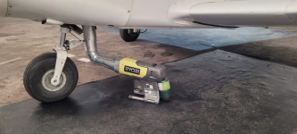

On another forum a guy has had success running a 12v amazon diesel heater. Even running it on avgas so no need to carry a fuel can.
Ironically, I was just looking at those a couple of days ago! less than $100. The can run with a 12V battery. Easily add some dryer vent tube. They have remote cabaility, but very limited distance, ie bluetooth.

I bought 2 of the 8kw versions with 120v adapters so I could work in my un-sealed un-insulated hanger. I'm very impressed with them. It will be summer again before I'm flying, but next winter I plan to use them both blowing into the cowl. I'm betting that if I leave the cabin heat on it will warm there too.
In the post I referenced he runs his on a cordless tool battery. That would make a great setup for backcountry flying. Heat the tent overnight then heat the plane in the morning.
That Vevor heater looks like you would need to also have a separate fuel tank.
If you click on the link, it shows a small fuel tank. Research I read suggested it lasts up to 19 hours. 10L/2.6 gallon tank.
Mine are a larger version with built in tanks a bit over a gallon. On low settings they will run over night. On high I'm guessing 6 hrs or so. The guy using his for pre-heating has a small version. He just siphon's a bit of avgas from his plane into a small plastic cup. And powers it with a Milwaukee drill battery.
He posted a lot of details and testing. It's on the POA forum.
