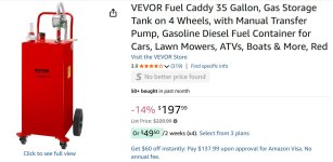

You have 38 gallon tanks built in (6A). What you need is this. It will pump the fuel out of your tanks, and back in when needed.
