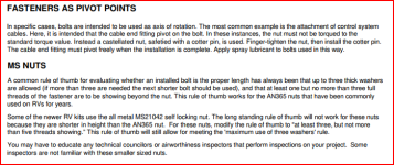

Another very important instruction is "
Fasteners as Pivot Points" is on page 05-20. As a DAR performing Airworthiness Inspections I have seen a couple installations, particularly on the rudder pedals, where the pivot point bolts were torqued to spec before installing the cotter pins, and the joint would not pivot an intended. Be aware anytime you install a castellated nut fastener that you understand the design intent!
