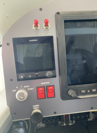

Pretty clean way to do it, Galin. I don't have a key switch, so I just used toggle switches, but with a key switch, this looks nice, and is super clear for the next pilot.
IMHO as long as they are spring loaded toggle switches, like bkervaski posted, then that is also a great way to go. Eliminates the possibility of unintentionally leaving the switch in the OFF mode, which I know I would eventually wind up doing.
