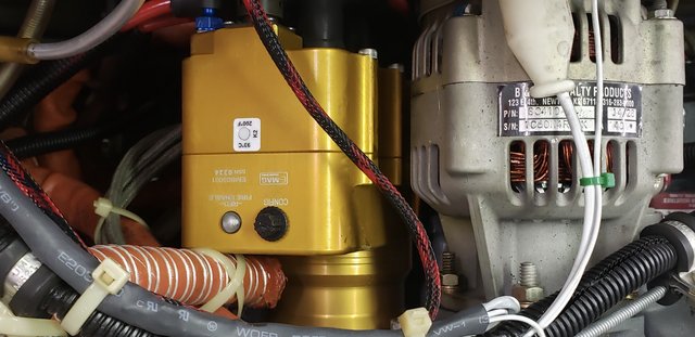

Yesterday I installed the production verson of the six cylinder pMag on the RV-10. Install was simple and it functions as advertised.
As many are now adding a B&C backup alternator on their RV-10 I wanted to show how both fit. This is the 20 amp B&C 410-H alternator. I suspect that the larger 30 amp B&C 462 unit may not fit as well, both for the pMag and other interference. For a backup alternator it is way overkill anyway.
Carl
Appreciate seeing this. I have the same BU Alternator and was curious how it would fit.
I plan in the next year to do a dual emag setup. Figured annual was a good time to mess with it.
