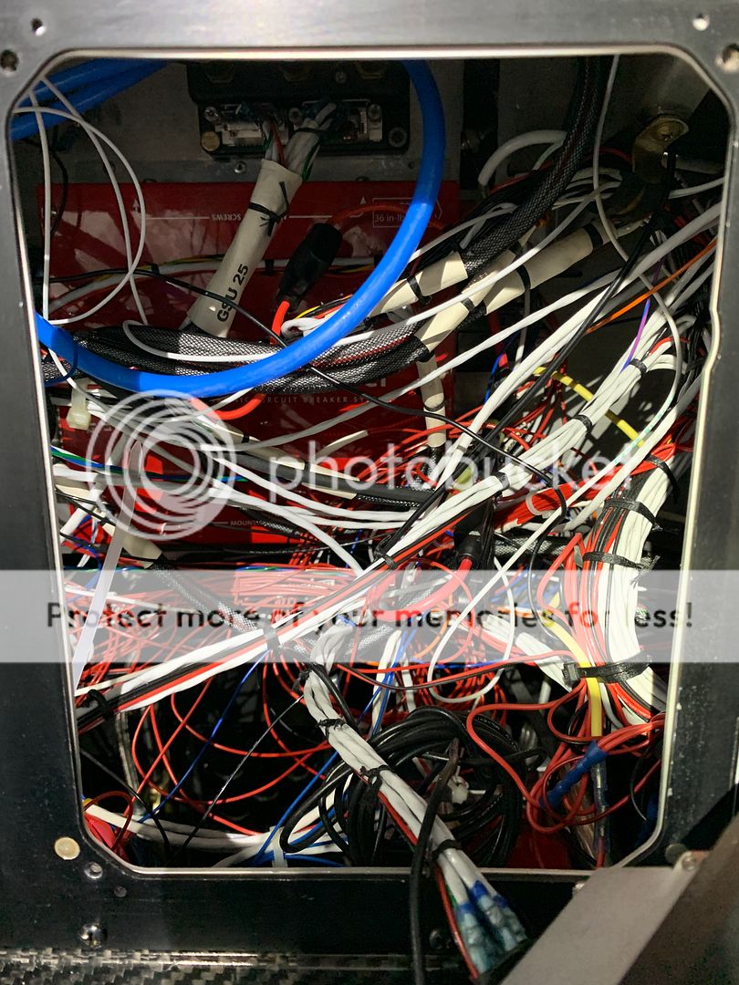

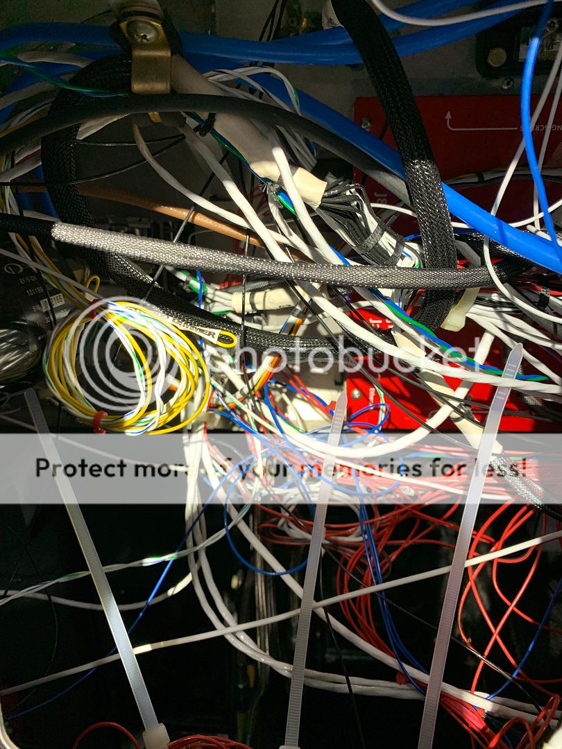

I'm trying to contain myself as I write this. We have an RV-10 in the shop that is having heading issues, along with some intermittents. Configuration is a G3X (non-touch).
Removing the PFD show's a real rat's nest of wiring behind it.
Finally found the ADAHRS after a lengthy search. It was high up on the bulkhead behind the instrument panel, above the VPX. It was mounted with one cable tie through the two top holes. Nothing else. No bolts at all. For those of you with a keen eye, yes there is a bolt now in the lower-left corner, as I finally remembered to take a picture after we started installing bolts.
Personally, I think this kind of workmanship borders on criminal. Especially when compensation is involved.
This was an RV-10 where there was compensation involved in the building process. I will leave it at that. It's now on its second owners, who are airline captains and fly it IFR.
Suffice it to say that if you don't know what you are doing, then don't do it. Somebody is going to get hurt.
End of vent.

It would be interesting to see the "after" pictures once you have it tidied up, assuming it is not going to leave the shop if it is not right.
I can see that some of the wiring has been bundled and laced in the "before" pictures, so there was some attempt at order, but for some reason that was not continued through for the whole job. I wonder if two or more people worked on it, it looks like different hands did e.g. all those red wires, we'll never know.

There is just flat-out no excuse for this lack of workmanship. And there's really no excuse for an owner accepting it.
I've seen grade-schoolers do a neater job on their science fair projects...who on earth thinks that this is acceptable for an *aircraft*?
It doesn't have to comply with the NASA wiring spec, but it ought to at least *appear* to have been done with some care and thought...this is atrocious.

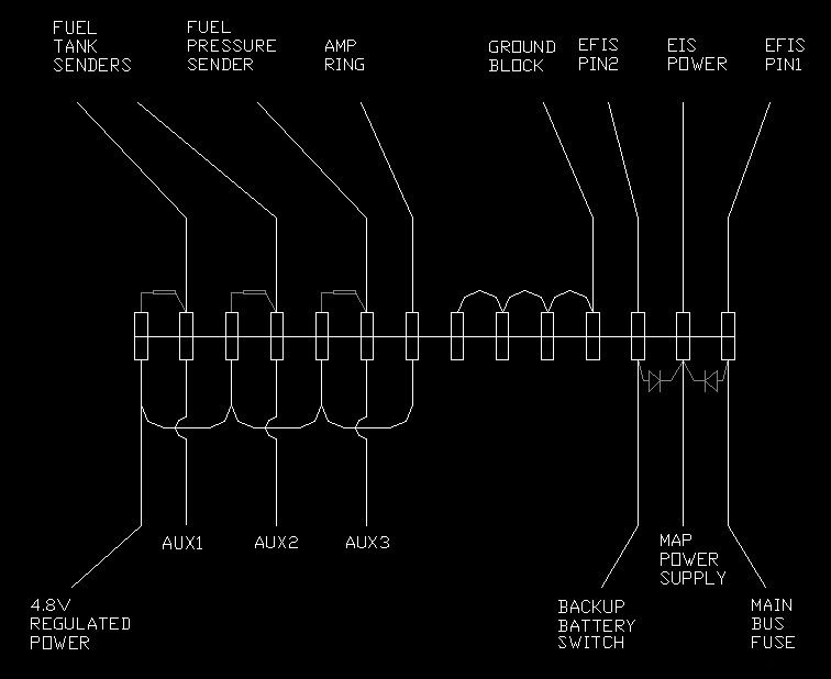

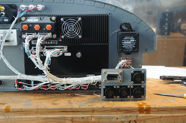

Interconnection Board
The wiring in my 'other' (non RV) EAB aircraft, which was built by an electronics engineer (not me), has all instrument and avionics electrical connections via a custom interconnect board that is mounted on the firewall behind the panel. Instead of traditional point-point wiring, there is instead a harness for each instrument or device or switch sub-panel to the interconnect board. Any item can be removed simply by unplugging the harness from the interconnect board and pulling it out. This does away with the need for service loops and makes for a much tidier wiring installation overall.
I think that the LSA RV-12 may be wired this way, i.e. via a central interconnection hub module.
This concept seems to work quite well in practice, there are however a couple of constraints. Firstly, the whole installation needs to be fully detailed before constructing the interconnection PCB, and then any significant future panel changes will be restricted by the interconnection board layout. And you need to know how to design and order manufacturing of a PCB and then solder the header pins and components onto the PCB.
Picture of a spare interconnection board attached for interest. I am considering doing the wiring for my RV-6A this way when I get to that stage, probably using a breadboard type PCB.

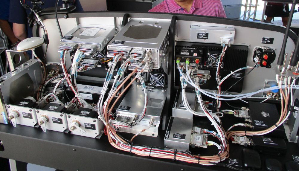

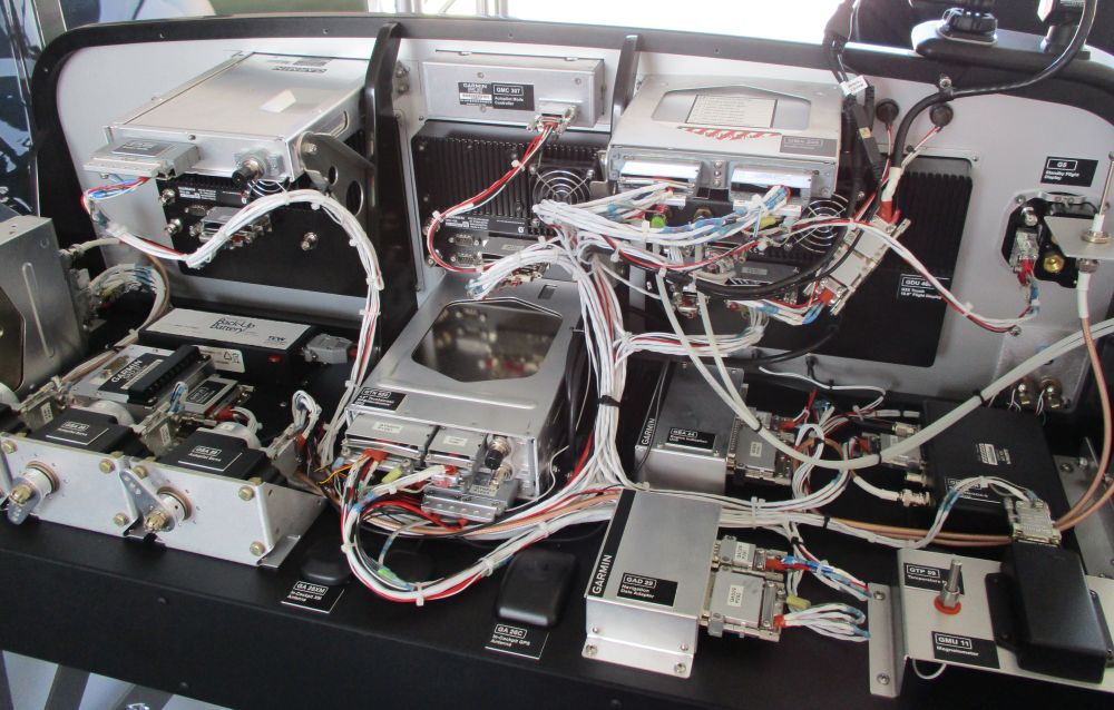

How about some inspirational photos? These from the Garmin display at OSH a few years ago:
The recent "wiring hub" approach to avionics is can be good, but they don't typically cover airframe wiring. Let's not forget a classic approach, the trusty junction block, which can be used for interfaces of all kinds.

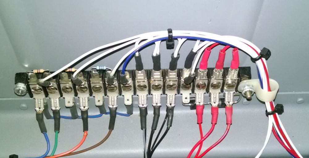

Quick note on the above. I have a preference for high quality bare terminals and seal-sealing adhesive heat shrink. They are bulletproof, as the wire crimp can be inspected prior to cover, and adhesive heat shrink provides better strain relief than a classic amp terminal. However, they are slow to fabricate and I would not expect a pro shop to do them unless you are clearly willing to pay the resulting labor bill. That inconvenient truth doesn't apply if you are wiring your own...and like me, you enjoy it.

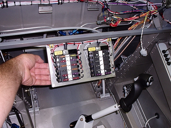

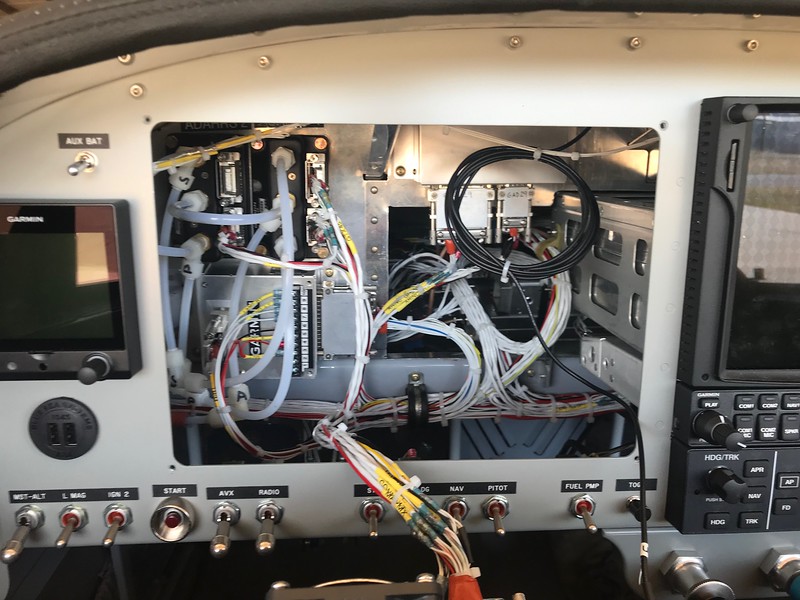

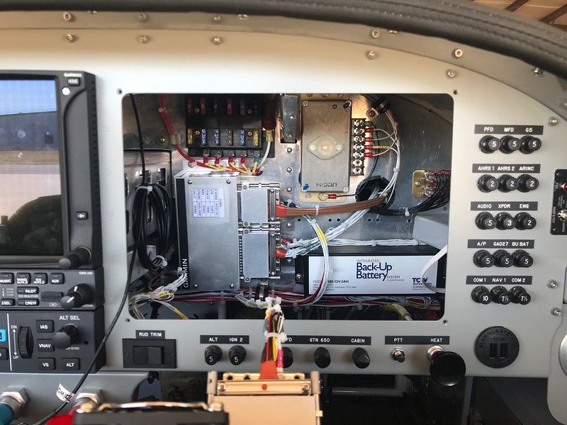

I don't usually take pics behind the panel but I I'll start doing it to showcase my work.
Here's a couple pics I sent to the customer so he could see what lay behind the screens.
I didn’t build my RV; I bought it, and in my opinion the wiring job done by the builder was very neat and effective. That said, when it came back from Walt’s shop, the result was top notch. The peace of mind is easily worth the labor cost, and the end product is beautiful, and functional. I’m mid-condition inspection now, and the organization makes maintenance a breeze.
Folks, that's what pro work should look like.
