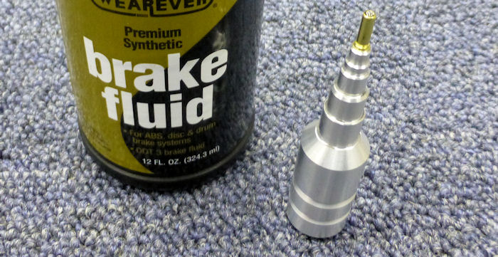

No drilling
This worked fine and no drilling.
Hot water this tool and drop of brake fluid.
See
http://www.joesrv12.com/Builder Log/bl_32_02.htm
