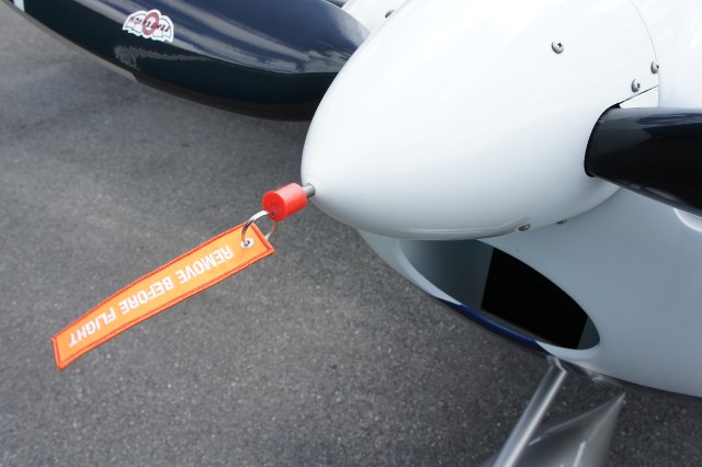

Has anyone come up with a trick way to protect that sharp and pesky little pitot tube? Yesterday I walked past it and put a hole in my arm....that will heal...but I don't wanna damage the little thing by doing that again.

Best one I saw was a guy who put a yellow tennis ball over it!
I fabricated a little plastic thread cap over it, made a small hole in the tip, and tied a plastic Do Not Remove to the inlet plugs. Works well?.until it's off and you knock your arm against it!! :p
We fashioned a pitot blank from a standard aircraft hose blank with a 'remove before flight' key fob (since upgraded to a Red Bull 'Flying Bulls' version!). A small hole prevents pressure change problems.
Prime reason for it is to prevent things climbing in and blocking the pitot tube, secondary reason is to prevent blood loss.
A secondary method is to leave the tow bar attached. Now I am the number one advocate of removing tow bars before you let go of it but on the RV-12, it does help keep peoples skin away from the sharp end of an RV-12....
See the modifications sticky thread at the top of the RV12 forum. A couple of good ideas in there.
I put a 5/16" vinyl screw protector on my pitot tube. Hillman part 881039 from Lowes.
Not only does it protect the pitot tube, it also protects skin. The vinyl cap fits tightly.
I put a very small vent hole in the end of the vinyl cap to prevent stressing the Dynon pressure sensor.
The hole is big enough for light to shine through, but will keep all but the tiniest bugs out.
One time I forgot to remove the cap, but the airspeed indicator and AOA worked as normal.
Those functions depend on pressure, not airflow. If the airspeed works OK with the cap on, then why take it off?
So I have left the cap on for the last several flights with no apparent indication errors.
I used the rubber bulb off a Rogaine eye dropper with a REMOVE BEFORE FLIGHT key chain fob as a flag. I got way more usefulness out of it as a pitot cover than as a hair restorative!😝

During air show displays I typically install a pitot tube cover (a strip of brightly-colored cloth with a big knot in the middle of it that slips over the pitot tube) and a brightly-colored cloth streamer that clips onto the stall warning vane. Both of these covers are cheap and help prevent spectator injury.
ps -- Beware of tight-fitting pitot tube covers that tend to over-pressurize the pitot system when being installed.

I use a tennis ball. Small slit in one side for the pitot tube, and I punched a couple of holes with an awl in the other side and attached a little "Remove before flight" keyring with an inch or two of safety wire. The streamer isn't really needed, I just had it laying around and used it. Easy to put on, easy to take off, and hard to lose. And it's bright yellow, so it even matches the airplane.

I cut off a short piece of 2x2, rounded one end, drilled a hole in the unrounded end the size of the pitot tube, painted it red, and hung a "Remove before flight" banner on it. I needed it because small children seem to have an undeniable urge to put mud into any open hole they find.
In post 7 above, I said that I left the vinyl cap (with a very small hole) on the pitot tube while flying. Airspeed seems to work OK, but AOA sounds the alarm at higher airspeeds. I no longer fly with the pitot tube cover on.
