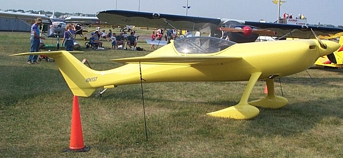

I didn't invent the idea. It's straight from the composites community. Best known early example was probably Cory Bird's Symmetry, but there are plenty more in the EZ world.
Seals the surface with a moderately hard shell which block sands flat.
