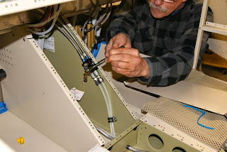

Piper - Yes, I have installed a Matco parking brake on the right tunnel rib.
Am not flying yet, but mounting the Matco parking brake high on the right tunnel rib seems to be a good location for the parking brake ... and clear of the rudder cables.

Thanks John. I too am interested in a parking brake and from what I see I like your install and would like to know more.
Where did you get yours?
Did it come with fittings? Or did the instructions call out which parts were needed?
Does the lever on & off come out the top or side of the tunnel?
Thanks again.

Patrick - It has been a while, but I?m almost positive I ordered the Matco parking brake through Aircraft Spruce.
About the same time I ordered the parking brake, I also ordered the Aircraft Specialty?s vinyl coated Teflon brake line kit for the RV-12. I told Steve at Aircraft Specialty that I was planning on installing the Matco PVPV-D parking brake so he could make shorter lines to interface with the Matco parking brake ? also had them include the proper fittings for what I was doing. So they supplied all the fittings for their lines and also included the fittings that go onto the aft side of the parking where the standard Van?s poly line attaches and runs to the landing gear mounts. Aircraft Specialty brake lines were also utilized from the landing gear mounts to the wheels. (Aircraft Specialty's brake lines are top notch and Steve was great to work with).
The on/off lever on the Matco parking brake does NOT come out of the tunnel and moves within the tunnel ? because the parking brake is mounted sideways following the slope of the tunnel, the lever actually moves parallel to the tunnel rib cover, but underneath it. A pull cable will be used to activate the brake.

My last plane for many years was a Cherokee, maybe that is why I thought I had to have one. It is inexpensive and very easy to install, so why not have one. Here is a photo of mine:
