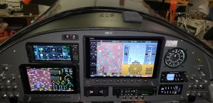

I'm trying to finalize the panel layout on my RV-8 and am thinking about where to put the ignition switches and starter button. Almost every RV-8 panel I've seen has the starter and ignition switches on the right side, so I'm thinking there must be a reason for that, but I'm also wondering if it makes more sense to be on the left side.
The only taildraggers I have flown have carbureted engines--I hold the stick back with one hand and use the other hand to start with no need to immediately adjust the mixture on start. My -8 has a fuel injected engine, so I will need to hold the stick back, push the starter, and then push the mixture forward. Unless I hold the stick back with my legs or grow another arm, it sounds like I will need to very quickly move my hand from the starter button to the mixture control. If the starter is on the left side then there is very little distance between the starter and mixture control. I'm also thinking about engine out scenarios. If the fuel pump and ignition switches are on the left side then I can fly the plane with my right hand and use my left hand to make sure the throttle, fuel valve and ignition switches are set appropriately and flip on the fuel pump without having to switch hands or reach over the cockpit.
Is my thinking off and is there a good reason that most people put the ignition on the right side?

I agree with the starter switch on the right. Here is how I did mine with engine switches on right side console panel I made and CB's and engine controls on
the left.
