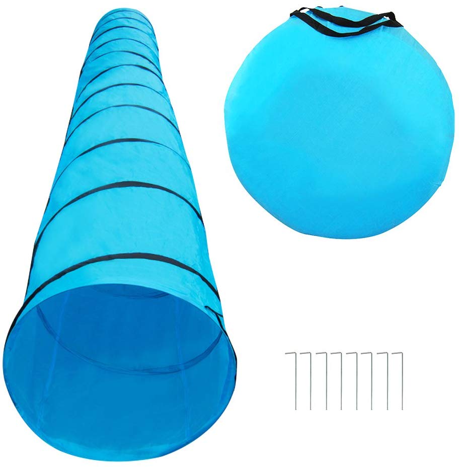

For the over spray issue, you can buy an 18 foot x 24" diameter dog agility collapsible tunnel and direct the spray away with a fan. If you put a couple of bends in the tunnel the over spray will never even make it to the exit end and will just fall into the tunnel, all you get is the paint smell. It works really well, I painted my airplane in my paint booth and had lots of other stuff in the area (tractors, cars) and got zero over spray on anything else.
