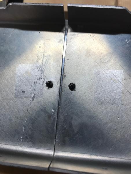

Hey guys, on page 38-14, section 4, joining C-01405-R+L, did you have a small (3/32'ish) gap between these two pieces once everything was together before match drilling the Canopy Handle Assembly?
Not sure it is correct, but it is what I got.
Mine does
The C-01442C Canopy Fixture when cleco'ed on created a gap very much like yours. I went with it; and it seems to work now that I am fitting the canopy.
Completely duplicate set of parts, exact same result, moving on ... (thanks for the responses)
