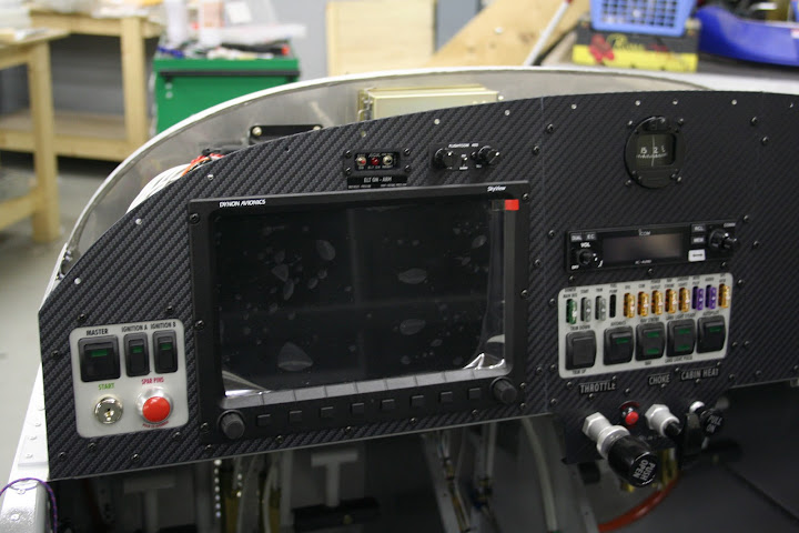

You might choose to locate the intercom and ELT to above the Skyview. The Vans demo plane is like this. If so you will need a different right side panel, Vans can supply.
Also see the mods sticky thread regarding slotting the engine controls.
And finally - the engine control stick-on labels look cheap. I had a trophy shop make a labeled metal strip. Two holes in the ends for screws, and it overlays countersunk screws underneath it. looks much better. I used non-countersunk screws on the whole panel except for those, liked the look. See the pics.
