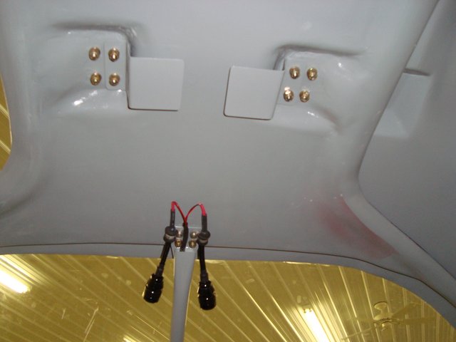

I have my wiring for the overhead light going forward through small grommets and into the center post. Doing this will show about 2" of exposed wiring. To make it look not quite as bad as bare wires, I used black heat shrink in the exposed area. Looks fine to me. For a completely hidden method, you can get some idea's by looking at Ed's website on how he integrated his console to the center post.
I have the Aveo Eyebeam Touch. It's pretty neat, but I haven't put it to the test yet. I have it installed between the two vent locations. It fits nicely in the space there.
I'm not overly worried about the exposed wire out the front. Since I'm going with a VPX I would think that would be the easiest as opposed to running out the back and then up front. Should probably see how those connections to that would work.

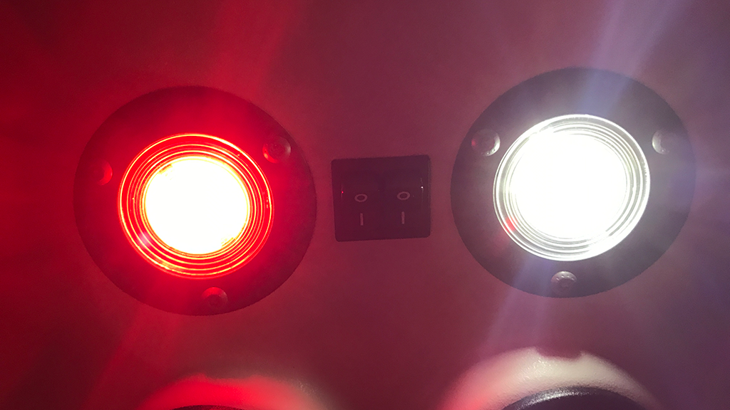

I used the following and though not flying yet, it seems to light up the panel and cabin very nicely. Ran all wires out the front of the console and down the center post. I'm going to have my wife use her crafty powers to make some kind of velcro-attachable fabric cover for the exposed area.
Red light strip along the underside of the glare shield:
http://www.aircraftspruce.com/pages/st/manu_crazedpilot/ledcockpitred.php
Red/white aim-able LEDs over pilot and co-pilot. White is switched from panel. Red is switched individually.
http://aircraftproducts.wicksaircraft.com/item/all-categories/ories-aircraft-lighting-oplite-oplite-6-dual-color/op6-w-r12?plpver=10
Two white LEDs over rear passenger area and two white in baggage area switched from panel. And 1 Blue LED individually switched over each rear passenger.
http://www.aircraftspruce.com/catalog/inpages/LEDUnderpanel.php?clickkey=3007988
Last few pics show my installation with the lights on.

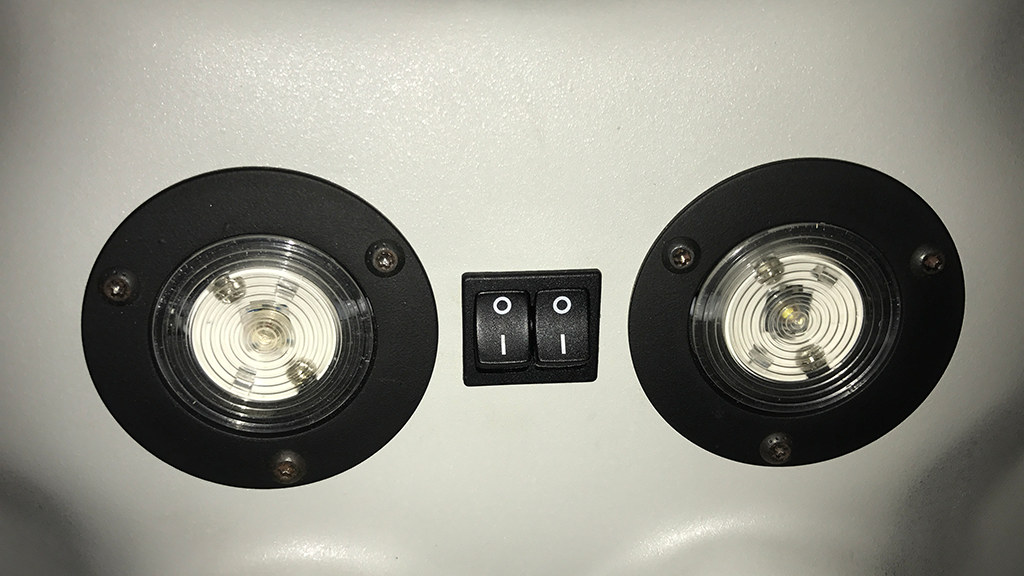

I found some LED reading lights at IKEA that had an aluminum body with mounting screws around the flange and a removable clear polycarbonate lens. I used 4 of them. I replaced the LED in one of them to red so I can use that at night.
They are driven by Meanwell LDD-350LW drivers, which are around $5 each. I tried a bunch of other drivers, some are putting out RFI even a hundred feet away. The Meanwell ones are awesome. No radio noise at all. I use them for my Nav lights too.
Cheap, nice looking, and plenty of light.
Lenny
I made these out of cheap clip-on LED battery powered lights. I cut off the battery and clip, replaced the LEDs with the ones I wanted (the housing was the key part). Done.
I may have spent $10.
The lights can be directed but stay where you put them. Plenty bright so they need to be on a dimmer.
