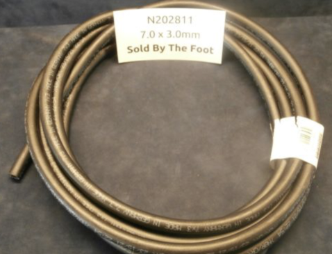

I too had issues with the hose to the coolant overflow bottle. I installed the hose months prior to adding coolant to the system. Discovered the hose at the bottle was already beginning to split when adding the coolant to the system prior to first flight. (And, yes, the hose was initially cut using a proper tubing cutter with a very sharp blade)
The real issue here is we are trying to install an American sized Gates 3/16" hose onto metric 8mm pipes with 9mm nipples. I solved the issue by going to a foreign car parts store and bought metric sized 7 mm fuel hose (believe it is VW Beetle fuel hose). I did a write-up on the Blog about the issue along with with measurements .... for those interested in reading about it.

Upgraded this hose in 2015 during my 5 year rubber replacement exercise.
Used a coolant specific hose rated for high-temp and Vacuum. I feel the temperature rating is important to prevent early hose failure. The hose is blue color. You can order it by the foot. I bought enough for 3 airplanes.
If you order something from this supplier (McMaster-Carr) make sure you check the shipping option, I think the default is overnight air $$.
Used NAPA automotive spring type clamps visible in this picture. There is a need to be careful if clamps are used that it doesn't interfere with opening the coolant cap. Larger OD hose and clamp is very close to the cap.
