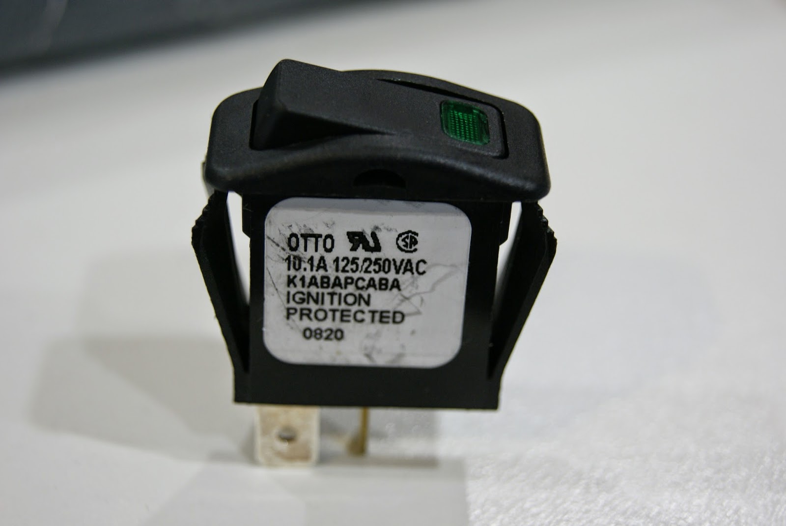

I need some help on installing a switch to turn off the elec. fuel pump .
I want to install the switch on the instrument panel. To interrupt the positive wire with the switch, which wire number do I interrupt coming from the switch/ fuse panel?
I have been told it is number 1 wire. Don't know if that is correct and if it is, where do you read the number ( i.e. What part of the cannon plug - front or back do you read the number from?
Fuel Pump Switch
Do NOT switch power coming from pin 1 of the switch module because that will shut off the avionics cooling fans. The avionics could overheat. Instead, insert the switch in the wire that is connected to pin 29 of the fuselage D-Sub connector. That wire should be 18 AWG with RED insulation. It should be easy to find because it is the only 18 AWG wire. All of the rest on the fuselage connector are 22 AWG.
I have a fuel pump switch for ground operations. I never shut the electric pump off while flying.
The builder of my 12 put a Klixon breaker next to the fuel valve. That seems a lot easier than putting it in the panel. I use it instead of pulling the fuse on the ground (avionics work, etc) but like Joe never use it in flight.
Jim -
Follow Joe's advise.
Also, if you want the fuel pump switch to match the rest of the switches installed on the RV-12 you can order an Otto K1ABAPCABA switch.
