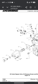

Oil screen O320 E2D
Ssaqibsiddiqui
Active Member
Patron
I am unsure how to remove the oil screen for inspection since this is the first time dealing with screens. Always had filters. Debating on moving to remote oil filter adaptor. I have been told that the hex but is vernatherm. Any help is appreciated

Just take the screen housing out there is nothing holding the screen in place. You should install an oil filter adapter while it is off, the 25 hour oil change interval is a pain.

Awesome. I was looking for this yesterday but couldn’t find. I was tired with other stuff anyway. Can you please share that doc if possible. Also do I have to remove hex nut 21 to make that screen loose?
No! And that is not a Hex Nut - that is your Vernatherm.

Make sure you have the housing and gasket oriented as shown on figure 19.
