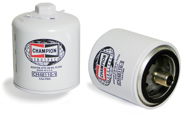

Tried searching everywhere, but any searches typically talk about sump capacity and the level at which oil is lost faster due to being blown out the breather. I want to know how much actual oil goes into a typical Lycoming IO-360 oil filter.
Specifically I am using these:
When I change my oil, I add 7 qts. It's hard to read exact levels unless it has been sitting a while and cold, so I don't know how much of that is consumed by filling the filter right after running it.
I was assuming a bit less, but it would be favorable for me if it was that much (trying to gauge oil consumption on a newish engine)
At oil and filter change, fill to 7 quarts, run to check for leaks... let set for an hour or so. Top off to 7 quarts.
Check oil level when cold before each flight to figure consumption of last flight.
I would guess that around half a quart goes in the 110 filter; I just did an oil change and the 109 filter that I use, which is longer than the 110, used about 26 ounces to prefill the filter...

I have the parallel valve IO-360, and its happy place is right around six quarts of oil. If I go seven, it blows it out pretty quickly.
As far as what oil the filter holds, it can vary. If you have a remote oil filter (like an Airwolf), it sits upright and can hold close to a quart. If you have the type engine mount that the filter is almost upside down, then most drains back out. Then there's probably the most common that mounts horizontally, and it holds somewhere in between the two styles.
Only two oil changes so not much experience. I add 7 at oil change and leave till next day. Pull the stick and make a mental note of level. Almost 7. After first run, I do the same next morning. That's my reference point. The stick reads just above 6. Difference is in the filter for what it's worth. She is happiest at 6 and typically blows the rest overboard.
