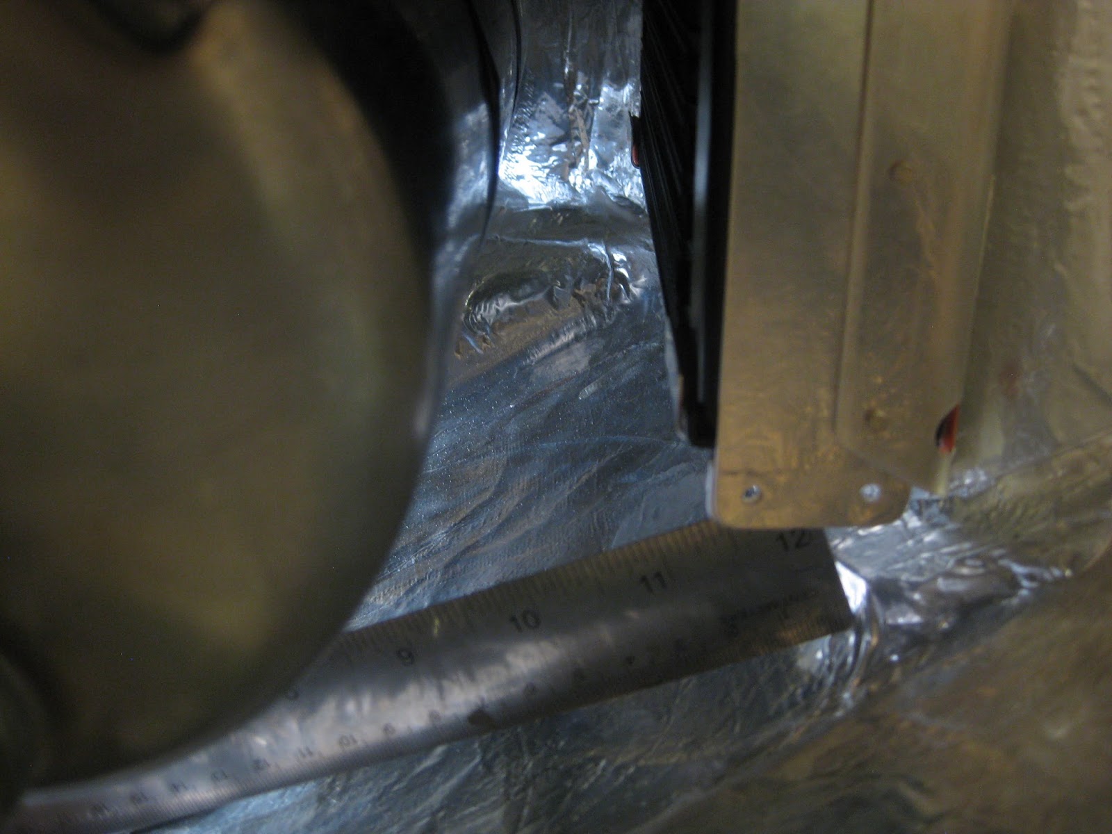

I have less than a 1/2" of space between the oil cooler and muffler. I haven't epoxied the duct to lower cowl. Anyone have an average measurement for this.
I have seen a photo of the duct cut out. Does anyone have better photos and possibly instructions or dimension to do the job? Need help as fiberglass repair is not one of my strong points. Thanks for your help!

If you have not fixed its position yet, change it so that you can get 1" at least. I had about a 1/3rd of an inch and lots of hot oil readings. I moved it about 1 inch forward and solved all of the cooling problems. Sorry I don't have pictures but if you search for oil cooler mod you will find them.

Concur, you need more space
I had major oil temperature problems in our Texas summer heat. Not being able to directly measure my spacing I took several measurements from the firewall and determined that I only had 1/8 inch spacing between the oilcooler and muffler. I moved the oil cooler 1inch further forward with the lower cowling mod and have had no more oil temperature problems in our 100 f + days. IMHO you need at least 1inch between the oil cooler and muffler if you fly in The Texas summer heat. In the 90's today.

I moved the cooler forward also and solved my high oil temp problems. It should be MUCH easier to do this during the build than later. Search for Cowl Duct Modification-- good photos and a source for drawings that work.

living in Tucson, AZ I did not wait to discover cooling problems and I modified the oil cooler position during the build:
http://torstensrv-12.blogspot.com/2012/11/modifying-cooling-duct.html
This gave me a good enough clearance to the muffler when the oil cooler was mounted:

Although Roger's info on prop pitching is spot-on, many 12 owners have had no choice but to modify the cowl duct. With the oil cooler as close to the muffler as many are (were), re-pitching the prop did not help. At this point there are enough success stories with this procedure, we know it will solve the problem. Bottom Line-you need at least 1 inch of clearance.

Rod, beautiful job! I've just installed my RV-12 engine, including oil cooler, and I've glassed the shroud to the lower cowl and I'm ready to order the avionics kit and complete the 12. However, I notice, as others have that there is only about a 3/8 inch gap between the oil cooler and the muffler! I, too, live in a hot climate...many days each year near/over 100 degrees. I, now, see yours and other threads on the web concerning this same issue. Wish I had known of this problem before glassing the shroud to the lower cowling. Has Vans engineering given any recommendations? If I need to cut & reglass part of the schroud as you have done so expertly, I would like to do it before painting. what are your thoughts? Thx!

With the temps in Calafornia I would do the "mod".
I also modified the cowl after glassing in the shroud like in the link mentioned before ; modify cowl
No big deal, couple of hours work. My test flight was at a temperature off 77*F, the oil temp at the end of the climb was just 200*F, during cruise dropped to 185*F. Flying now with a strip off 2" to block the radiator to get the temps up.
