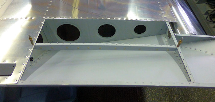

I know this subject has been discussed many times and for the most part I have had it in control to a acceptable point.
I finished my wing tanks and finely closed up my skins on the top of the wings a few weeks ago.
The W-1204B Skins at the outboard end of the wings have Oil Canning that has caused me not to get a good night sleep since then.
This area is 13.75" by 23.1" and is a simple span design ( one side at the end of the wing and the opposite on the last outboard wing rib ) and should provide about 22.93 lbs of lift.
It is also the largest and most flat area on the top of the wing.
The span on the wing ribs is only about 11.6" ( 2.15" less than the W-1204B span ).
I went out to the shop today and removed the W-1204B skins and will order two new ones from Vans on Monday.
Has anyone had the same problem with this or maybe the dimpling of my skins in the problem.
I will make a stiffener out of the top 1.5" of two new wing ribs.
Any Suggestions are welcome
Joe Dallas

I have similar oil canning in that location on both wings, and I suspect it's probably quite common. It's probably got something to do with the way the twisted skin that forms the underside of the wingtip pulls on the ribs. Whatever the cause, the plane flies fine.

This is what my wing tip looks like, I just wish I had noticed it before painting and when I still had time to fix it. :mad:

I think that Robert is right
After taking off the skin I put a straightedge across the last wing rib and the flange of the W-1204-L.
The W-1204-L top flange was not on the same plane as the top of the wing.
I was able to tweak the top flange of the W-1204-L flange and alien it with the plane of the top of the wing.
I may have caused this problem myself by dimpling the flanges for flush rivets.
For you who have not installed the top W-1204-B skins, I would cleco and not rivet them until the W-1204D Wing tip close out is installed.
Then remove the top skin and check the angle of the top flange and tweak if necessary ( pinch or open ).
