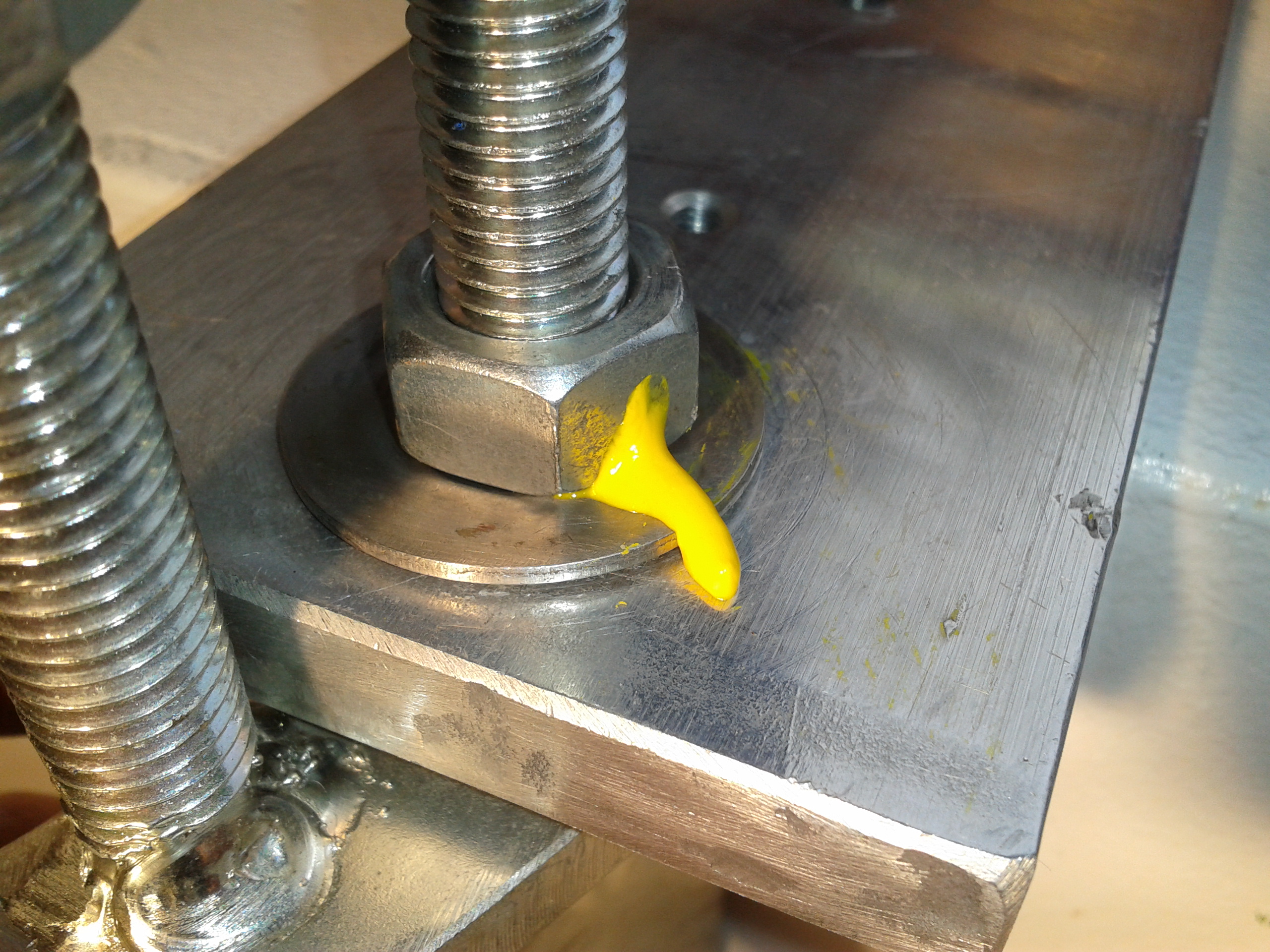

I have seen torque seal stay on the nut and end of the exposed threads of the bolt as I was loosening it off. To your point torque seal is not always an indication of a bolt and nut being tight.
It's not the point of it being tight. It's to ensure I will see when the nut has backed out. Of course, putting a wrench on the bolts and nuts is done at every inspection, when it is a regular locknut or castle nut. Yes I have found that bolts and nuts needed additional torque during the more frequent phase 1 inspections and less so now it has accumulated more hours.

seems to me that if torque seal is not absolutely 100% reliable then it is worthless and better not to use it.
Its purpose is as an indicator that it was torqued. I think torque “seal” is a bad product description. It doesn’t seal anything and isn’t even a very good indicator that the fastener moved either as others noted.
I use it to mark that I torqued it, at one point in time, for what that’s worth.
This is the same reason I use torque seal on the jamnuts. During pre-flight, I can see if the jamnuts on the tail control links are still in place. In theory, when properly torqued, the jamnuts should not move. But at night, or low light, it's much easier to see when the torque seal rather than checking the gaps by eye. I do this for all the jamnuts on the airplane, from the aileron control rods, elevator torque rod, engine control cable ends, etc. So far after 1 1/2 year of flying, I have not had a jamnut coming loose but the torque seals let me check them easier.
At the risk of taking some heat, I'll chime in. If you're putting torque seal on the THREADS, you're doing it wrong. Torque seal goes on the nut, the underlying washer and the thing being bolted together, NOT the threads. Like this:
