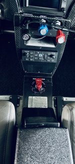

charlesmc Member May 28, 2024 #1 I'd like to add nut plates to our Andair fuel selector. I'm away from the hangar and forgot to measure these before I left. Will K1000-3s fit here? Or do we need some other type of nut plate? Thanks in advance

G gkochers Well Known Member Friend May 28, 2024 #2 charlesmc said: I'd like to add nut plates to our Andair fuel selector. I'm away from the hangar and forgot to measure these before I left. Will K1000-3s fit here? Or do we need some other type of nut plate? Thanks in advance View attachment 63652 Click to expand... I installed standard k1000 nut plates here. Nothing special.

dmattmul Well Known Member Benefactor Sponsor May 29, 2024 #3 See pic. Attachments Screenshot 2024-05-29 120032.jpg 78 KB · Views: 55
J Jesse23 Well Known Member May 29, 2024 #5 gkochers said: I installed standard k1000 nut plates here. Nothing special. Click to expand... Same as well. Also added nut plates under the selector base vs nyloc nuts supplied. Attachments IMG_4925.jpeg 1,014.6 KB · Views: 50

charlesmc Member May 30, 2024 #6 Jesse23 said: Same as well. Also added nut plates under the selector base vs nyloc nuts supplied. Click to expand... Nice install
