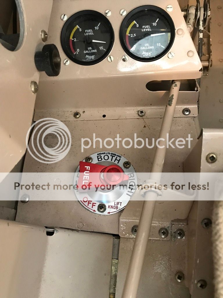

Please, please, please don't do this. I was performing a prebuy on an RV-8 today and for the second time I found a fuel valve with a BOTH position. Huge NO-NO! A both position in a low wing aircraft will fool you into thinking it works correctly, especially when both tanks are either full or above the fuel pickup. But let one of the tanks get below a fuel pickup and even if you happen to have a full tank on the other side, it will suck air. Probably at the worst time, like when turning base to final. More accidents are caused by modifications to the fuel systems than any other modification. It was a even very nice Andair valve, too. 😓
In spite of the overwhelming presence of the internet, and the push to have EAA Technical Counselor visits mid-build, I am still surprised/dismayed by how many "lone wolf" builders there are that aren't seeking technical help from anyone. The fuel valve error should have been caught....by someone....
In our area we always gently suggest a social visit by local builders when we find a new project under way. Multiple sets of eyeballs can prevent heartache further down the road.
I can surely see this as an easy gotcha for someone. I didn't step in this pothole myself, but could see the simple overlook not thinking.

When I was a DAR, I once would NOT issue the Airworthiness Paperwork to an RV-6A builder/owner/applicant till the builder changed the fuel selector to one that did NOT have BOTH. I explained how one tank could be full, the other sucking air with the switch in BOTH and the engine would quit running.
The builder / applicant changed the valve while I waited / watched.
it is my understanding that a L R fuel valve with no "BOTH" position still has one of you place the selector half way between the L and R. I has to be this way so that when switching tanks, the 2nd tank kicks in before the former tank is cut off. If so, be sure to place the fuel selector all the way to one position or the other and be aware of consequences for failing to do so on a low wing aircraft.

Here's the deviation from the FAR often seen on Rockets (and maybe the -4?):
?23.995 Fuel valves and controls.
(g) Fuel tank selector valves must?
(1) Require a separate and distinct action to place the selector in the ?OFF? position; and
(2) Have the tank selector positions located in such a manner that it is impossible for the selector to pass through the ?OFF? position when changing from one tank to another.

Vic, it may be possible that the "BOTH" position is not plumbed. Did you ask the owner if he actually gets fuel out of the "BOTH" port. It may just be a capped port. In my aircraft I have the same valve but the centre port is capped and labelled "AUX". It is available only for a temporary ferry tank.
Mind you, if the central port is indeed capped it is certainly misleading and dangerous for it to be labelled "BOTH" (for obvious reasons).
An "AUX" input port is different than a "BOTH" position on the selector. The BOTH position is an internal configuration that allows the tanks to feed simultaneously.

Vic is dead on target. The whole BOTH problem can be traced back to the 1920's and it has everything to do with balanced vent pressures above each tank.
The CAA certification regulations were revised to state that in order for a fuel system to be approved for a simultaneous feed valve position (i. e. BOTH) the air space above each tank's fuel level must be interconnected in order to balance the vent pressures. This requirement was written in blood. There is no reference to high wing or low wing.
If two or more tanks without common vents were simultaneously fed there is a chance for fuel starvation and in extreme cases one of the tanks to run dry and physically collapse depending on the venting. In other cases the pressure difference would transfer all the fuel into one tank and vent vast amounts of fuel overboard until empty. The original Cessna 120/140 aircraft have a left/right/off selector just like the Sportsman mentioned above, all without BOTH despite all being high wing aircraft. This is because they don't have a tank vent air interconnect of the space above each tank's fuel. The later Cessna 140A model (and most subsequent high wing Cessnas) had a BOTH position due to having a cross vent tube between the tanks inside the headliner. This satisfied the tank air spaces having equal pressure and when combined with vented caps or per tank vents added more safety by allowing one or more tank vents being plugged while still providing continued normal operation via the cross-venting.. One had to be careful to use fully vented caps in the Cessna 120/140 aircraft rather than those with rubber flap check valves integrated within the cap. In the case of the 140A an extra ram air vent on the roof tee'd into the cross vent line The earlier non-BOTH Cessnas had quite a few fuel starvation accidents attributed to one clogged fuel vent.
Lots of gotchas in the older fuel system configurations.
High wing aircraft lend themselves to the BOTH selector due to it being extremely simple to interconnect and balance the vents as described above. However, since it's all about interconnected balanced venting and not wing position, a low wing aircraft could in fact be allowed a BOTH position if the fuel system has properly interconnected venting. Unfortunately as a rule low wing aicraft geometry provides for a difficult configuration to accomplish this in a practical manner. Who wants a vent line snaking from the left wing root to the right wing root across the seats or following a canopy bow? This impracticality is the reason the rule of thumb is simplified to a straight admonition to never have a BOTH position in a low wing aircraft.
It should rather be the more correct, and wordier: "Never have a multi-tank feed fuel selector in an aircraft unless the vent air in the top of each tank is physically connected."
I have never seen an RV with the appropriate interconnected vents for a BOTH position but that doesn't mean it couldn't be done with an appropriate amount of effort, weight, aesthetic hit and inconvenience.
This particular rule isn't an example of beaucratic overkill. It was devised by airframe and systems designers to keep good folks from being killed.
