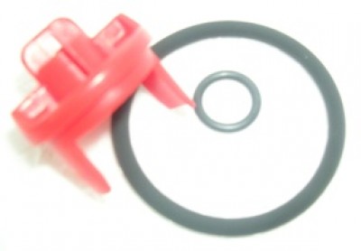

REPLACEMENT O-RING KIT FOR A20L FUEL CAP
I have 4 of these fuel caps. Thats an $84 set of o-rings and plastic clips. AHHHH! Each kit has 3 o-rings and a red retainer clip. What I really needed was a sample retainer clip so I could figure out how its retained in the cap, and fabricate the proper tool.
You will see in the pictures below, that the tool is quite simple. Tap the tool onto the end of the cap, spread the little fingers out just a little, and pry the plastic retainer off. I was able to easily do this with all for fuel caps without breaking anything. KEY ITEM, Only spread the fingers out enough to get the retainer off.
Pull it apart, take the 3 o-rings to your local supplier and get the ones you need.
