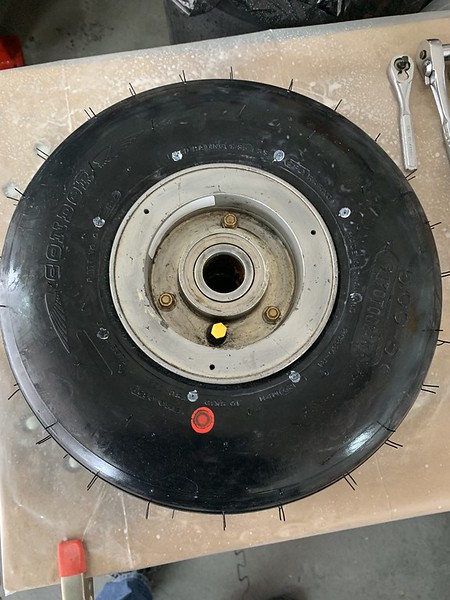

Line up that valve-stem with the red dot. Aired up to 50 pounds.
First time I ever had a valve stem slide right into place. This has usually required some pulling and pushing and a few choice words. This time I put some Marvel Tool Oil on rubber grommet in the wheel and it slide right through with little resistance.

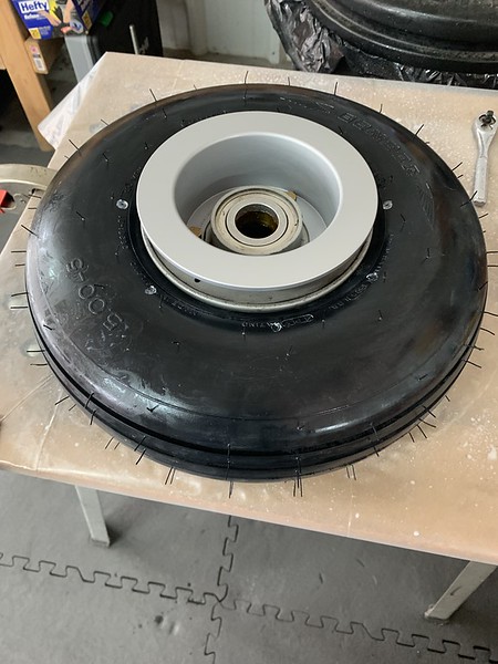

The new rotors will never look so good again.

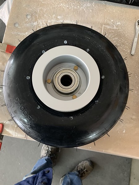

Wheel bolts torqued to 90-inch pounds per Cleveland.
