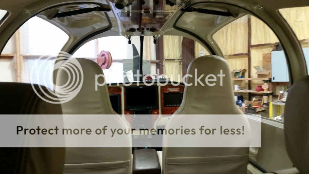

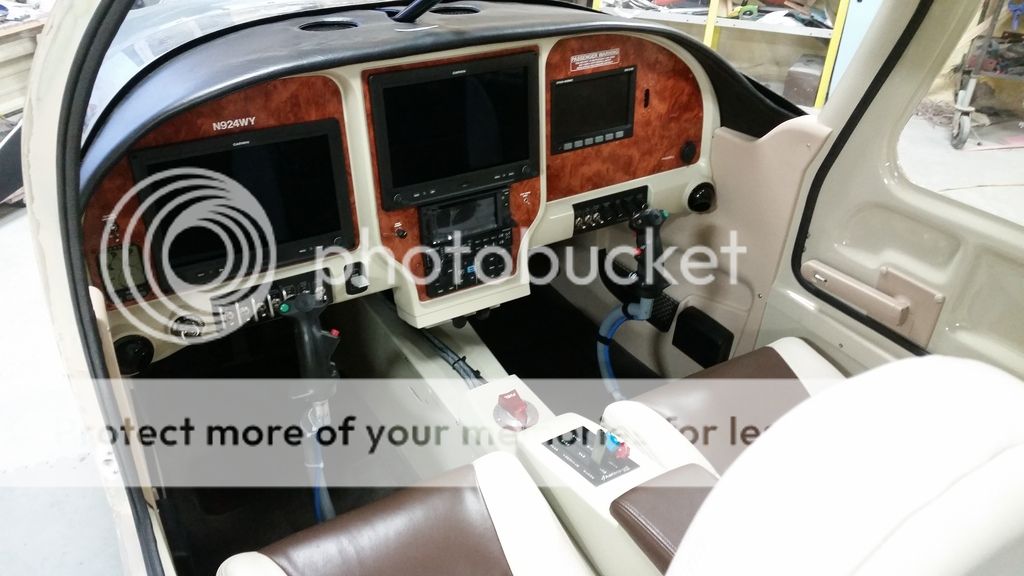

Looks great! Do you have a closeup of those switch groups? I'd like to see how you did those. I'm also glad to see that you were able to fit a GMC307 at the bottom. I'm going to switch out my 305 and I was a little worried that it might be a bit tight.
And you're going to love that center quadrant! They're fantastic!!
I had a local lady that does some fabric work do the dash pad for me. I was very pleased with it. I used 3M to adhere it to the underside where it laps around and it worked great.
There is a company in Idaho that we found that does the panel switch lighting, it was all one piece LED sandwiched together to about 1/8" thick. I am very pleased how the light on the switches turned out.
Dave came by today and we did the weight and balance. 1643.5 with no paint, a little heavier then what I thought it would be but Dave says it's good. Also got it started today.
A big shoot out to Dave Godwin for coming over today and helping me make it like he said "burn a little gas".
