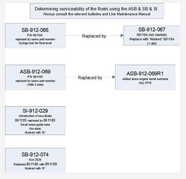

Dec-2020 / Rotax Mandatory (Float) SB
Here it is ladies and gentlemen... the latest addition to your Rotax/Bing float collection! But wait, there's more; Rumor has it that work has begun on a custom shadow frame so you proudly display your float collection. Details to follow.
LINK to Rotax UL SB >> https://legacy.rotaxowner.com/si_tb_info/serviceb/sb-912-074ul.pdf

If you read SB 74UL an 74 you are all confused. Its a puzzle.
The engine serial number is clear and after its a lot of if then else
I think easiest is to directly pull the bowls and check for the R and replace if no R
This will be float type number 5 or 6 ?

Apologize for linking to the Certified SB in my original post... all fixed now.
I too have lost track on the number of Rotax/Bing float revisions. The list below was taken from the Certified SB. Staggering!!
