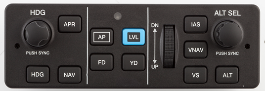

Yes, the G5 based autopilot will follow the guidance from the 430W and allow you to fly autopilot coupled LPV approaches with both lateral and vertical coupling (with a flight director).I want to add the following to gain additional functionality, specifically:
1. Garmin GM 307 Autopilot Controller (replace TruTrak)
2. Garmin GSA 28 (X2) Autopilot servos
3. Garmin G5 Flight Instrument (Backup to AS 4500)(Replace ASI, VSI, ALT)
4. Garmin GAD 29 Nav Date Adaptor
Will the above proposed combination of items enable the use of the autopilot for GPS steering, WAAS LPV vertical approach guidance?
If the Garmin GNS 430W was being used for an IFR approach and the APR button on the GMC 307 autopilot control panel was activated, will the the autopilot fly the approach and will the Area 660 show the aircraft's position on the approach plate?
With a flight plan entered into 430W and the 307 was being used, what happens if the 430W goes off-line? Does the 660 become the navigator and drive the G5 and in turn the 307? Is it automatic?

If you did, you would certainly fly home with a smile on your face with the autopilot coupled to the Aera 660 both laterally and vertically (with a flight director).
Steve, Quick question on this. If you do lose the 430W in flight (or 650/750) how would the 660 provide vertical "guidance"? I know the 660 can provide Lateral guidance to the G5 which would steer the Autopilot, but I was not aware that the 660 would be able to provide vertical guidance if a primary IFR GPS fails. My understanding was that the only vertical information that a 660 could use to input in to an autopilot would be information similar to the VNAV profile but not as a back up to 430 on an LPV approach. That would be awesome if I am wrong![]()
