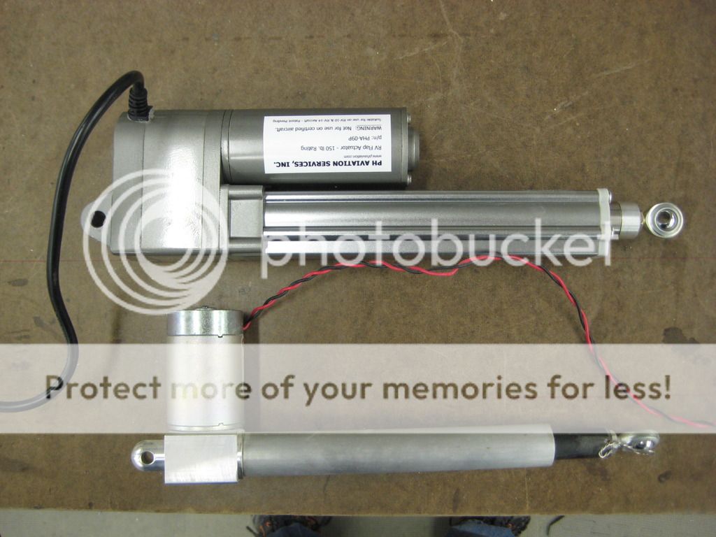

Here is a side by side comparison of the actuators:
The construction and finish of the new actuator is awesome!

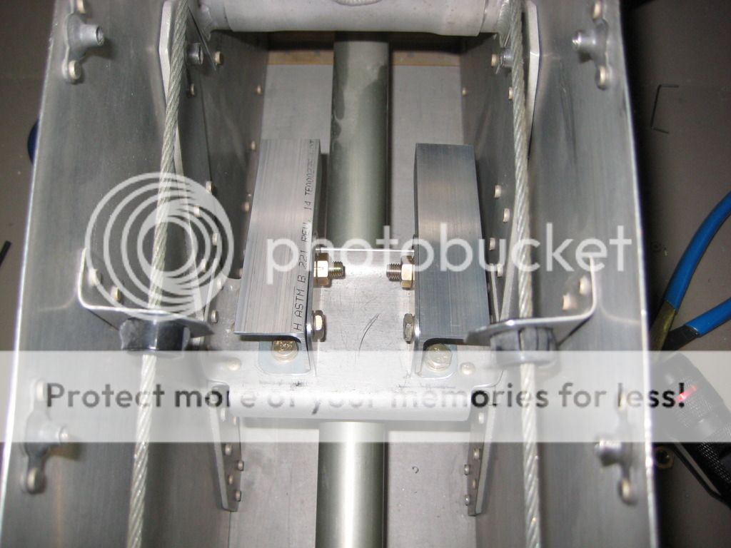

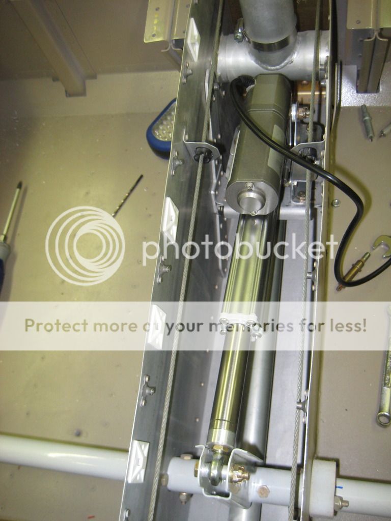

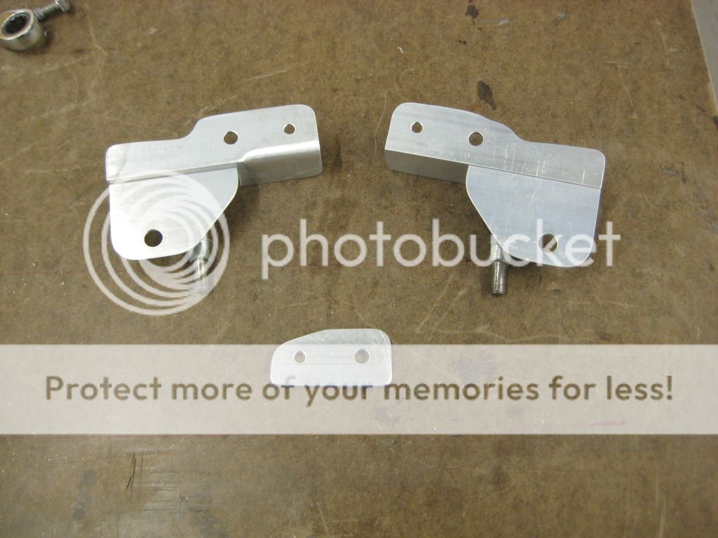

It took me about a day to retrofit my RV-10 which is about 90% complete. The install process involved fabricating a mount that bolts to the original actuator mount. As the new actuator is longer, the new mount extends the pivot point 1 1/2 inches farther forward. The mount was fabricated from 1/16 x 1 1/2 x 1 1/2 and 1/16 x 1 x 1 angle, and was a fairly simple task.
Installation during initial construction would be a breeze!

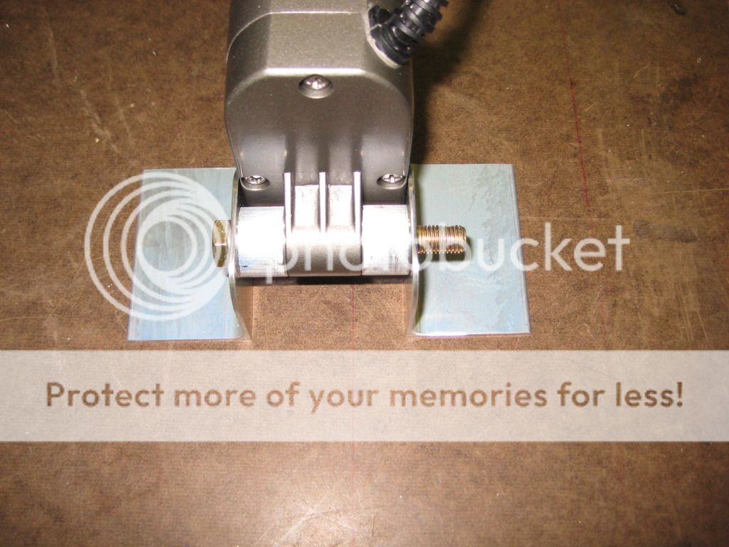

I made a couple of 5/16 ID x 5/8 OD spacers that were 1/2" long for the actuator pivot. I opted to add a washer on each side to increase the clearance on the actuator housing, though this was probably not necessary.
Once the actuator was centered in the tunnel and the pivot point was located 1 1/2" forward of the original, the mounting flanges were match drilled to the support angles. All parts were then removed, demurred, and finished. Nut plates were installed and the actuator was installed.
I needed to extend the rod end bearing about 1/4" to provide clearance on the flap bell crank. I tested the operation and range of motion and it was perfect!
The actuator is quiet and VERY smooth in operation. It has three additional sensor wires (just like the external position sensor) that will connect to an indicator.

It appears that the speed is about the same, and the weight is likely about 1 lb more...it definitely a more robust actuator.

Thanks to Bob for posting his comments on our new RV-10/-14 flap actuator! We are in the process of testing our first two production units and we'll be offering these for sale soon at $349 which includes the installed rod end bearing. The unit weighs 2 pounds 15 ounces, which is a little over a pound more than the stock flap motor. Time of full extension/retraction is about 12.5 seconds which compares closely to about 13 seconds for the stock unit.
