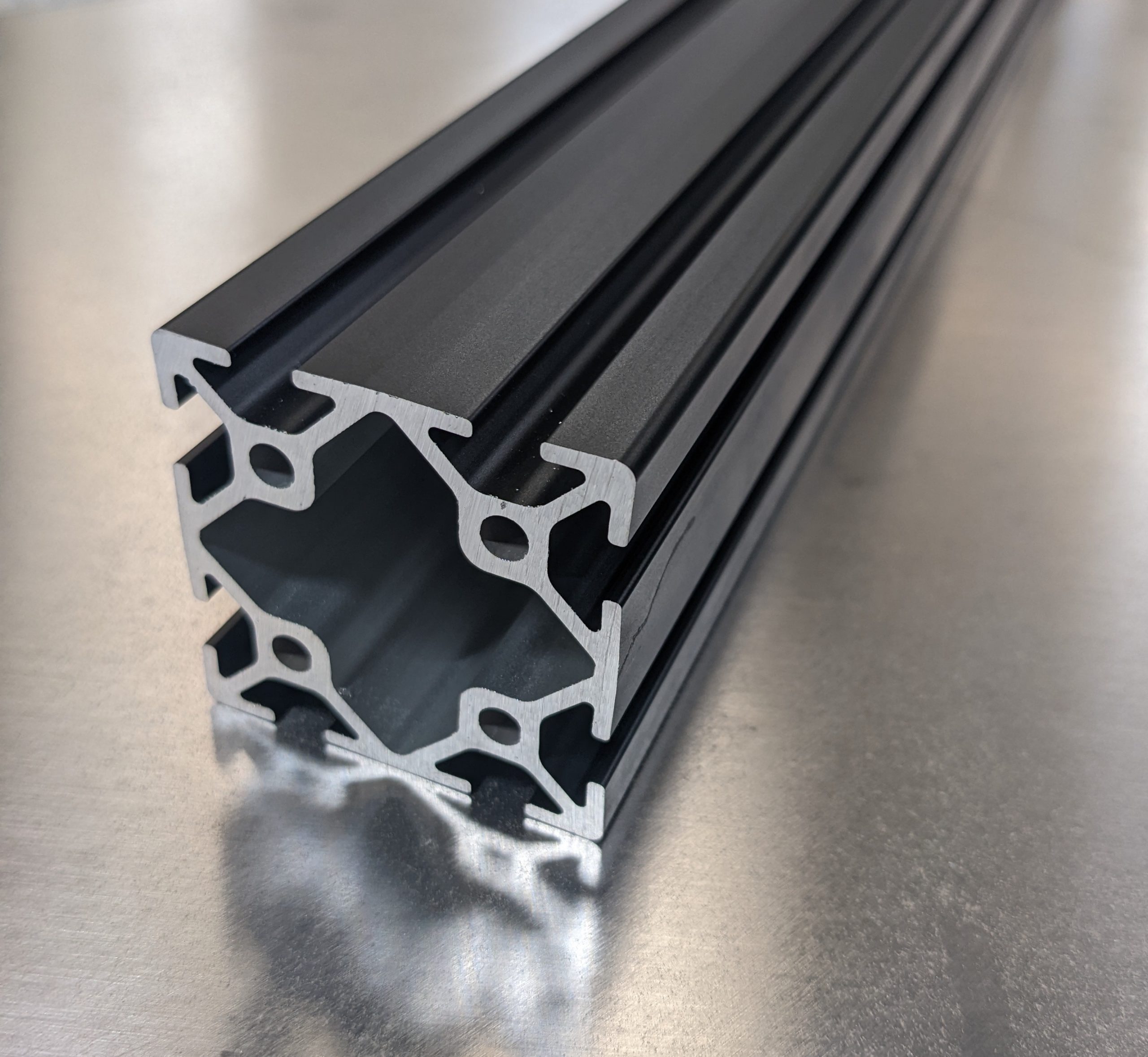

Id like to use some T-slot material (as I have used this for other fixtures in the past)
My concern is, about alignment: I have seen some mount directly to the floor, which is what im considering, but I doubt any floor is perfectly level, and with something of this length, Im worried it would be hard to tell if something was off from one end to the other.

8020 extrusions are overkill.

Yes, the T-slot extrusion is overkill, but if you've got access to it cheaply, then it's a good option.
