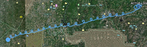

How to take an hour to go 58 NM at 151 kts
With some test time left to burn on the new engine, I elected to fly 58 NM to Gilliam - Mc Connell Airfield (5NC3) and have some BBQ at the Pick-n-Pig restaurant, located on the field.
As I pulled up my hangar neighbor had his new KitFox IV pulled out and ready for a flight. I suggested he meet me at the Pick-n-Pig only to realize that if I stayed with him, by the time I returned, I would have my test time flown off. The only problem was that I'm still breaking in my new engine, so I couldn't throttle back to KitFox speeds.
The plan was for him to fly at 2500' and I would stay down at 2000' and fly circles around him. The following is the plot from my GPS as played back on Google Earth.
I feel dizzy just looking at it.
You can see where I took off from our home airport and circled 1000' above pattern altitude until he fueled up and got airborne. Then it was off to 5NC3 where I again circled until after he landed.
Left turns were used so I could keep him in sight the entire flight.
