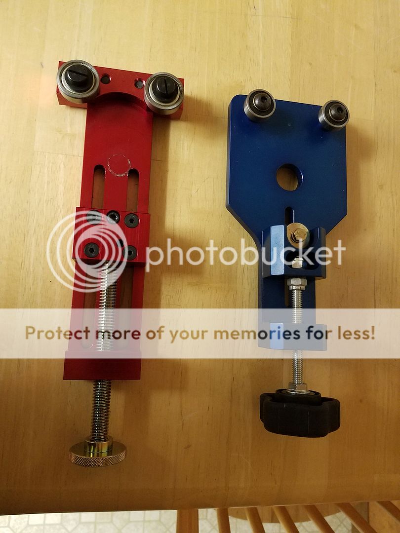

I've been using this one from Tempest:
https://tempestplus.com/shop/can-cutter/
I've been using it several times a year for the past 13 years. It's pricey, but it has worked very well for me. I don't remember how much it was when I purchased it, but I doubt it was anywhere near it's current price.

I've used the Airwolf cutter for many years & probably have opened well over a hundred filters with it. As mentioned above, gradual cutting pressure & about 3 revolutions produces a nice clean cut.
It's not as pretty as the others, but it works. I clamp the filter in a holder in a vise and turn the cutter and the oil stays in the canister.

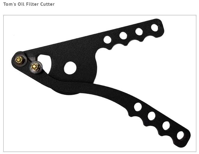

Well, I am the “Tom”, behind this cutter. The idea came to me while I was combining soybeans one fall day. It is a boring job and the mind tends to wander...
I had not really found a cutter that I liked and really wanted something simple that would cut different sizes of oil filters.
I am more of a idea guy than a marketing type so Vince and Blake took over the tool and I am very pleased that it is being promoted and used!

I bought one. It works great.
Tom,
I've got one and just never could get it to work. The side of the handle rubs against the filter and won't let the cutter go deep enough. Any idea what I'm doing wrong???
Thanks but I have never used any automotive filters.....only Champion or Tempest. I'm certain it's just me, others seem to really like it.
Tried the "Tom" tool, but
found it to be hard to use and could not get good cuts. I finally bit the $ bullet and bought the Airwolf. I recommend that one!
Ron
I cut a filter once a month on average. I had to cut the nipple to accommodate the red cutter. Then a good friend of mine gave me his old never used Avery tool. Love it! Bob made great tools back in the days.
