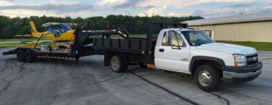

Chip, I've hauled literally dozens of airplanes, long distance and local. I use a modified 16 foot I've had more than 30 years, or a newer lowbed gooseneck with drive over wheelwells.
Tow slowly? Nope. I limit speed to 80...seriously.
Folks worry about damage on the highway, but that's nothing really. The real risk of damage is loading and unloading, so the key is having the right equipment, particularly good ramps and a winch. And you need 102" wide...car trailers and similar are too narrow between the wheelwells.
With an open trailer the tail can stay on. With an enclosed trailer most tails will need to come off. Note the A-frame for the tailspring. Positive fixation, longeron level.
Sometimes it's not so easy to remove the wings from an RV. I've seen a lot of crushed seat ribs aft of the spar in the side by side models for example. The A models have main gear weldments blocking easy access to drive out the spar bolts. Etc, etc. You can ugly up a nice airplane if you're not careful.
It's not a crazy requirement. If you're going any distance, the interstates are mandatory. It's a 75 mph world, so you equip accordingly. The airplane doesn't care. The key is vehicle stability.
Almost 50 years ago, as a young truck salesman in an upscale community, I built a following among rich ladies who wanted to tow horses. I pushed what I called "Sunday night rigs", overbuilt tow units that allowed tired ladies to drag their equine buddy home from the show after a cocktail or two.
The long wheelbase dually in the picture above is a pretty good example. It's more truck than strictly necessary, but it's rock solid out there in the left lane.

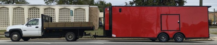

Yes Mickey, I've been doing it a long time, and I didn't say it was easy...but for perspective, I'd rather drag an airplane on a trailer than a recreational vehicle trailer (less weight, lower CG, etc.) and there are roughly 10 million of those in the US, behind non-professional drivers.
Then we have horse trailers, boat trailers, 4 wheeler trailers...and of course, box trailers. I dragged this one almost 1200 miles over a day and a half last week, because a fellow bought one of the Tango Flight RV-12 kits and I promised to deliver it.
Again, the real damage risk is loading, securing, and unloading.

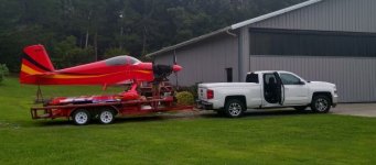

Here's a tip. See this Mustang II, and my RV-8 in the previous post? The customized trailer has wheel stops at the front corners, so taildraggers can easily end up too far forward for best stability...the CG of the airplane is about halfway between the rear axle of the truck and the trailer axles. It's OK dragging across town, but not so great at 75.
On this trailer, a nosewheel airplane always pulls better because the airplane is shifted aft on the trailer by two or three feet. The CG of the package is closer to the trailer axles. I'll chock a small taildragger like a Kitfox in a similar aft position just to gain stability. Perfect would put the CG just forward of the axles, much like we want the CG of our airplanes to be just forward of the aerodynamic center.
