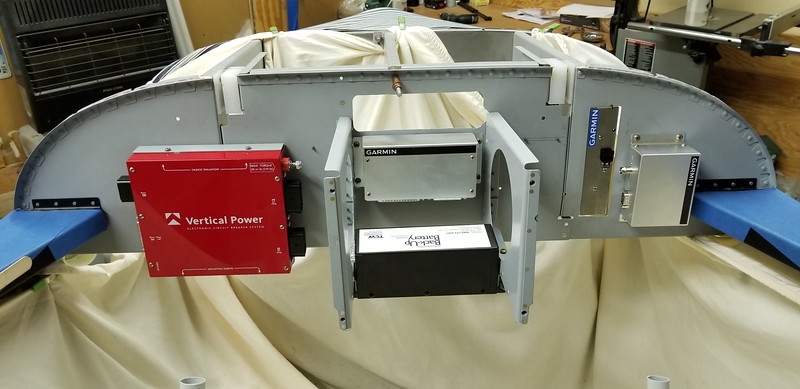

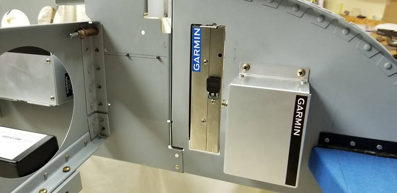

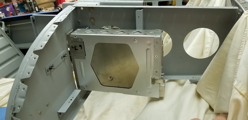

Based on the information provided by Levi a few posts ago, this is how it worked out for my install:
View from the back of the sub panel
View at the front of the sub panel
I'm pretty happy with the result, and the harness on my Stein panel reaches perfectly in this location. Thanks for the tip, Levi!

Behind the sub panel, or?
I chose this method not necessarily because I felt the GTX would need to be removed with any regularity, but instead because I didn't want anything mounted inaccessibly behind the sub panel. With five remote boxes, this was the only way to go.
