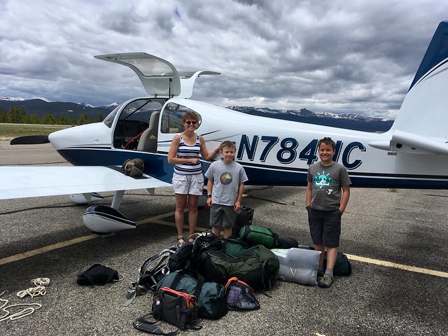

Good choice. We have flown our RV-10 into Leadville several times now and it has become one of our favorite destinations. We?ve skied at Ski Cooper, but also visited in summer to camp in the mountains and climb the peaks. We?ve now climbed six of the fourteeners in the area. It all really has been a great experience for my family. We will make a couple more visits in the coming year
The performance of the RV-10 makes the altitude pretty much a non factor, but you need to think about weather and turbulence. The airport sits in a broad valley ringed by 14000 ft peaks. We come in over the peaks, but if you have winds or clouds the easier approach would be up the valley from the south. Drop me an email at [email protected] if you want to talk in detail about places to stay and things to do.
