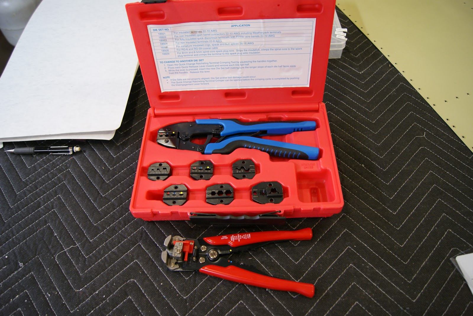

Because of the various electrical connectors used on the RV-12, the DOG Aviation procurement department opted for a crimping tool with changeable dies capable of crimping most of the electrical connectors used on the airplane ? except the round connector pins used on the avionics DB style connectors.
I purchased a Tool Aid crimping kit and am very pleased with the results. I bought the kit which has various quick-change interchangeable dies for the typical spade, ring and butt connectors, .092 Molex pins, coax crimps and non aviation spark plugs. HOWEVER, the kit did not have the die for the small .062 Molex pins, so I ordered the #18937 dies for that size connector directly from Tool Aid.
The #18937 die set has two crimping die sizes, I used the smaller of the two on the .062 molex pins used on the landing and nav/strobe connector and had great results. The kit was around $79, but the crimping tool can be purchased separately for much less. I think the #18937 die set was under $25.
Here is a photo that show the crimping tool set.
