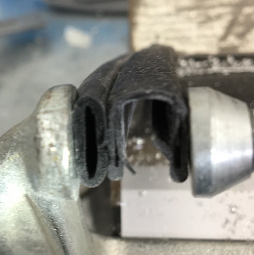

I'm getting ready to make lots of dust and making the seal area of the doors ready.
Based on lots of other postings I bought most common the McMaster-Carr 1120-A411 seal - 1/4 inch web and a 3/8 bulb.
All of the posting seem to say to leave a 0.25 inch gap for the seal to squish into, but my initial checking of a foot or two seem to make the bulb too compressed.
This is about 0.25 shown in a C-clamp -

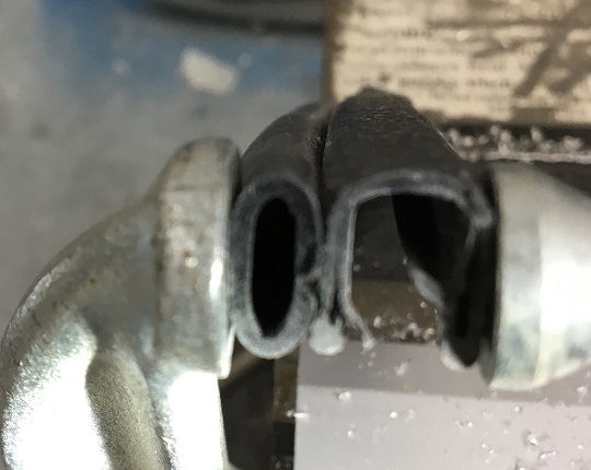

This is the view with an extra 1/16 inch gap -
Am I missing something here? It seems like the 5/16 gap would create a very adequate seal.
Did previous builders really use a precise 0.25 gap? Or was it "fudged" a bit larger?
My test areas have been in the middle of the sides and seem pretty representative.
Since the web needs sanding in spots and building up in others the seal I bought should be OK - I'm just not sure of the exact gap to make.

Frankly, I think that I like the first picture with the tighter squeeze. It will likely seal better. The second pic looks like it is just barely meeting or coming up short on the recommended minimum of 1/2D compression.

Frankly, I think that I like the first picture with the tighter squeeze. It will likely seal better. The second pic looks like it is just barely meeting or coming up short on the recommended 1/2D compression.

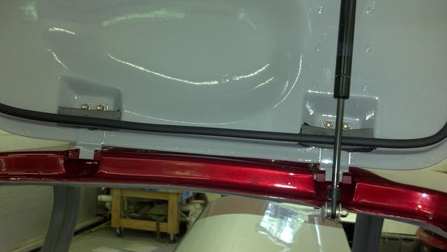

rear hinge gap
I don't know about the rest of you but living here in VT cabin heat can be an issue during winter. So I have spend at little bit of time looking for leaks. The biggest flow outflow of air for me is around the door seal near the rear door hinge. Because of the cut out required due to the hydraulic piston and hinge I am not getting a good seal with my Mcmastercard seal. I tried putting a piece of fiberglass across this area but interference with the piston resulted in me grinding/sanding a way a path for the piston and the recent cold spell has demonstrated yes I am still getting pretty good flow.
But I like the idea of putting the gasket on the door in that area. I am going to give it a try.
Thanks for the idea.
