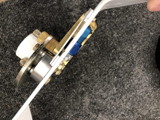

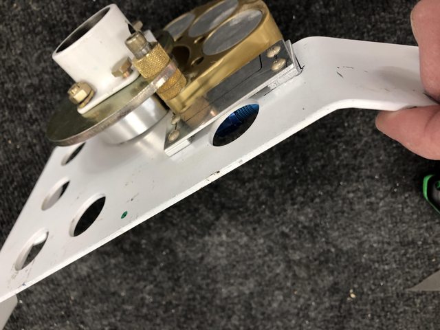

3) There is a fitting on the Matco calipers that interferes with the wheel pant brackets. Matco's suggestion is to form a bulge in the 1/8" aluminum plate brackets. That isn't within my capabilities, so I will cut away the offending area and rivet on a stiffener.

I'll make my contribution here - pics of the necessary mod to the wheel pant brackets if you lack the tooling and brute strength to put a bulge in .125" alclad.
modification
Just my two cents...
I trimmed out the area necessary to prevent contact and did not add any doubler. One year later there is no sign of any cracks or distress.
