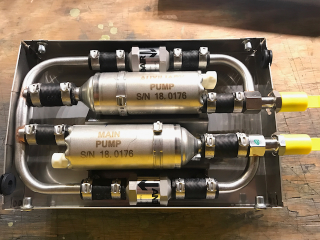

One problem I see in checking the serial numbe for the fuel pump assembly it?s that, per the KAI, the first thing to do is remove the cover on the fuel pump assembly, and not put it back on. We most likely disposed of this in-needed cover, so, unless we have the serial number on our documentation, we may be up that well-known polluted tributary without a means of propulsion. It appears the two actual fuel pumps do have serial number, which we could read?but we need to know what fuel pum ranges have the bad innards.
Well, yah, but
The SB indicates the potentially impacted S/N ranges: 180500-192699.
This is the ASSEMBLY part number range. This is on the cover of the assembly, which cover was removed for the RV12iS implementation. There are serial numbers on each of the two FUEL PUMPS, which we should still be able to read?but the service bulletin says nothing about the serial number range of the bad individual fuel pumps.
Well, I think I?m crying wolf
Looking at the fuel pump picture, the Assembly S/N is NOT on the cover we threw away?its on the base that the cover covers, so I should be able to see the serial number.
When you get the chance to look at the pumps you?ll see both the main and aux pumps carry the same part and S/N as the assembly, leading me to believe the entire assembly is the only way one can get them. I?d be happy if someone could prove that assumption wrong as it will be a more economical solution.
Hope this photo helps a bit for builders that are not sure where the S/N are and what they look like. These are mine before install. Lucky for me my S/N are not in the I'm screwed range.
