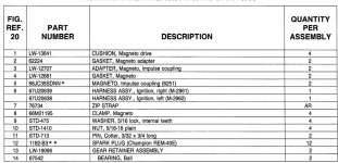

jmbrwn Well Known Member Patron Nov 28, 2024 #1 I'm changing the magneto cushions on my left Slick mag. The part number is LW-13641. These seem slightly smaller and fit looser than the ones I'm replacing. They do have tabs on them. Is this normal??
Walt Well Known Member Patron Nov 28, 2024 #2 There are at least a couple of different PN's for these. Looking at an older Lyc IPC the LW-13641 has the tabs and should be correct. The LW-12136 cushions were for the older retainers I think and didn't have the tabs. I don't have a current IPC so not sure if there are other PN's. https://www.lycoming.com/sites/default/files/attachments/Magneto%20Drive%20Gear%20and%20Cushion%20Modification.pdf Last edited: Nov 28, 2024
jmbrwn Well Known Member Patron Nov 28, 2024 #3 Walt said: There are at least a couple of different PN's for these. Looking at an older Lyc IPC the LW-13641 has the tabs and should be correct. The LW-12136 cushions were for the older retainers I think and didn't have the tabs. I don't have a current IPC so not sure if there are other PN's. https://www.lycoming.com/sites/default/files/attachments/Magneto%20Drive%20Gear%20and%20Cushion%20Modification.pdf View attachment 75284 Click to expand... Thank you Walt.
