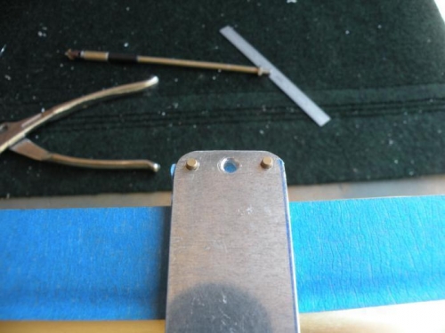

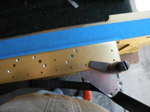

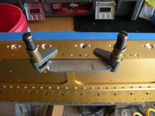

As far as countersinking for screws, I was concerned about damaging the nutplate threads, so I made a jig to center a countersink pilot on an unoccupied screw hole pre punched for a nutplate.:
Like many others, I also made dimple coupons of various sizes to aid in setting the countersink depth.
