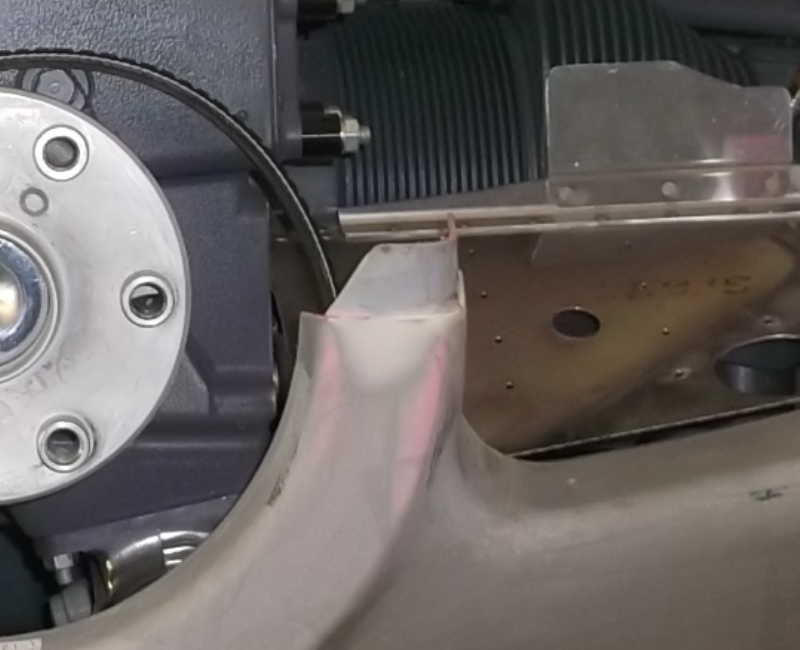

I have an issue with the fitting of the lower cowl now that I am up to final assembly. I have now final mounted the prop and need to find a way that allows for easy assembly of the lower cowl without completely disassembling the prop.
Have people had the same issue after following Vans plans? What did you do to fit the prop? Did you make additional cuts?
Did anyone disassemble the prop spinner mounting plate to complete the cowl fitting?

I'm confused by your statements, since you don't need to remove the prop or mounting plate to fit the cowl. Are you having issues getting the cowl on? Is it hitting engine accessories? It is an acquired skill getting it on, but it is possible.

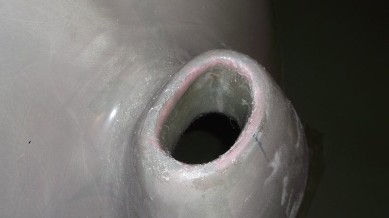

to solve this issue, I cut the scoop off the cowl and glassed a flange on the removable scoop, installed #8 nut plates on the inside of the cowl to attach the scoop. Now with the scoop removable the cowl is a snap to take on and off.

Posts above all have good suggestions. It is tight fit and I would add that the inlet ramp baffle should be cut to allow for clearance when lowering the cowl. If it is too close it will want to force the cowl into the spinner back when the baffle seal drops past the inlet ramp. I used the baffle seal from mcfarlane which added complexity because of the material flexibility.

1. Trim the lower cowl inlet ramp back to have at least an 1/2-3/4 inch gap when the cowl is installed. You can do this with a combination of trimming the cowl and the actual metal ramp. The lower portion is all that needs to be trimmed. Fill in the gap as called out in the plans. Use the material provided, if you try to use a thicker silicone baffle material it will defeat the purpose of the gap.
2. Extend the lower cowl opening for the nose gear strut. I don't recall how exactly much I extended mine, somewhere around an inch or two.
3. When you fabricate the baffle seal for the FAB, attach the upper seal to the FAB inlet, and the lower seal to the cowl inlet. This allows for no interference when installing the cowl. I posted a couple of photos below

I have had 3 RV's in the shop in the past year that had the scoop on the lower cowl be removable. In my opinion it's a fantastic idea. Makes getting the lower cowl on or off so easy, even a caveman could do it.
I have worked on a -10 with a 3-blade MT that has the bottom cowl in 2 pieces. It splits right down the middle. The really nice part about that is that you can pull off just one side if you want to work just on that side. It would take a guy who enjoys fiberglass to go that far, but it makes service really nice.

One sure way that worked well for me is to extend the inlet snout by 1 inch over the recommended length in the plans and cut the FAB front end shorter by 1 inch.
