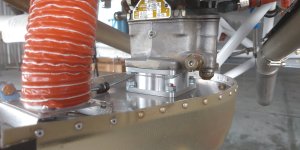

Did you ever go with the 3322? I’m due for an oil change and filter change. Mine is shrunk and want to not have to cut a notch if I can avoid it
An alternative that I have on my O-320 RV-6 is an aluminum spacer, about 9/16 thick, that puts the Fab and filter below the acceleratpr pump well.
So. no need to notch the air filter.
Do you have any photos of your 0320 FAB setup?
Here's a picture of the spacer that I made that drops the FAB down a little over an inch. I did it so that my FAB would line up with my cowl inlet better. A side effect was that the filter also clears the bump.
