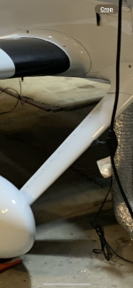

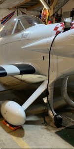

Looking for a better way. What are your ideas.
Hanging my 3rd pair of gear leg fairings. The first two were on an RV-4. The third time is going on an F-4 Raider/Rocket.
I do a lot of grass landings so there is probably more movement than most city planes.
The first time was done via Vans plans and rivets and piano hinges were used. Within a couple hundred hours, there was a ton of smoking rivets.
The second time I used piano hinges and number 4 screws. I simply threaded the #4 screws into the piano hinge. It looks cooler (IMHO) and it has lasted the test of time. I have no problem doing it again if I don’t come up with another idea.
What I’m leaning towards now, is a modified piece of aluminum stock to take the place of the piano hinge. Grind the aluminum stock to match the inside profile of the gear leg. Then drill and tap the angle and use #6 screws and skin washers.
Vans designed a fairly rugged plane, but my intersection fairings, gear leg fairings, and wheel pants always get a little beat up… so this time I want to find a better way. Looking forward to seeing some ideas or hearing some opinions.

The pics are my RV-4 gear legs with #4 screws.

Always rivet the piano hinges and can’t recall smoking rivets ever. Are you using “soft” or normal rivets? Do you pro seal or JB weld the hinge sections or just rely on the rivets?
I did the stock (I think!) Van's design using a split upper and lower fairing and hinge setup. I am not a fair-field lander either. I think the two pieces give it the extra flex it needs to put up with rougher terrain. Never had smoking rivets and the system seems to be working just fine. Stainless steel tape strategically placed at spots that rub help keep the aluminum from not wearing from the inside out. I just put on a new gear leg stiffener system using stiff fiberglass rods wrapped with layers of fiberglass. I have not flown since putting it on so the jury is not yet in the courtroom! It might change the dynamics of how the fairings work but I don't think so. I have the short gear. I like them! I think they are better with unforgiving terrain.

Thanks guys. I appreciate the help.
